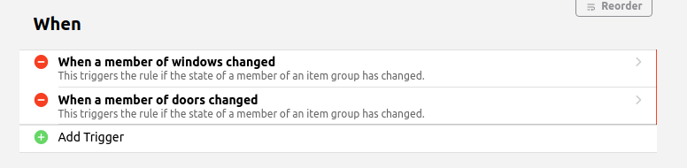

I have the following construct (that works)
But just for my understanding:
these groups “doors” and “windows” belong to another group called “doorsWindows”.
Is it possible to selct only “doorsWindows” and react on all their child updates?
(Btw. all groups are marked as BaseType: “Contact” and Aggregation Function: “One OPEN then OPEN else CLOSED”; Usecase is a TTS reminder via cronjob, but String should be prepared allready before)

Sorry I did not pronounced. I dit test and It does not work. So the correct question is: Do I have to take the workarrount like above (selecting all lowest groups) or is there a easier way?
yes and no I am using the Label of these groupt to concatenate my TTS String with the real world names for “window” and “door” like: “Guestbath-window is open since 15min”. or “Can not lock maindor, because some windows are open.”
