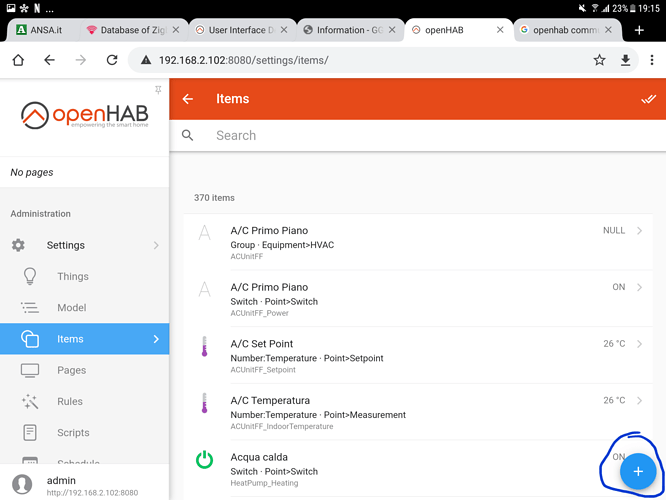

then you will have to create a virtual switch. If you want to create it through text files you just need something like this:
Switch VirtualSwitch "My virtual Switch" {alexa="PowerController.powerState"}
if you are using OH3 main UI then you need to create a switch item and add alexa metadata to it, specifying it’s a PowerController.powerState.
When you are done with the above, you need to run your alexa app on your mobile phone or tablet and look for new devices: then VirtualSwitch should be visibile in your alexa app and you should be able to switch it on/off from alexa.
