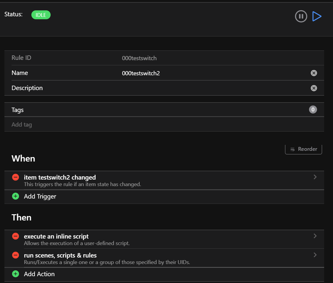

This is the rule (one item only, no group, so triggeringItem should be null indeed):
(Sorry for screenshots… just in case I have tunnel vision and miss something obvious).

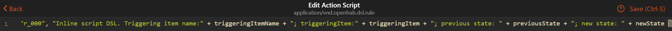

this is the inline script:
logInfo("r_000", "DSL script (not inline). Triggering item name:" + triggeringItemName + "; triggeringItem:" + triggeringItem + "; previous state: " + previousState + "; new state: " + newState )
this is the code for the external script (test9.script):
logInfo("r_000", "Inline script DSL. Triggering item name:" + triggeringItemName + "; triggeringItem:" + triggeringItem + "; previous state: " + previousState + "; new state: " + newState )

You should click on the code tab and post the YAML you find there. That shows the full definition of the rule in all it’s details. For example…

I’m pretty sure that the run scenes, scripts & rules action is a trigger by itself, so when the code is executed, the trigger is indeed not the triggering item any longer.
That is true, I missed that detail about what is going on here.
If the log statement in the called rule is the one we are talking about, I would expect all the implicit variables to be null.

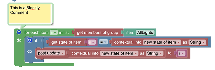

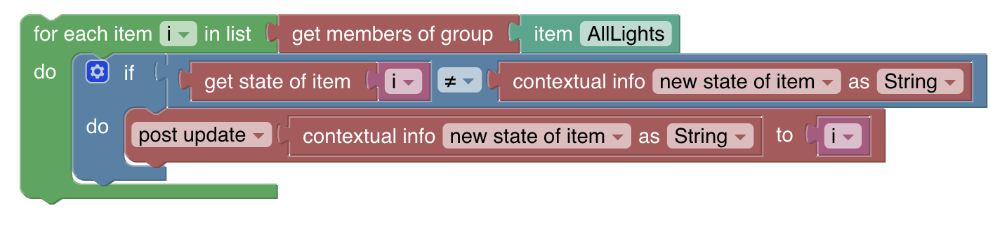

Note that Blockly compiles to JS Scripting. It’s a great tool for learning. You can build up the blocks and then look at the JS Scripting code that gets generated.
For example:
which is a little bit of code to synchronize the state of members of a Group converts to this when you click on the “show generated code” tab.
var i_list = items.getItem('AllLights').members;
for (var i_index in i_list) {
  i = i_list[i_index];
  if (items.getItem(i).state != event.itemState?.toString()) {
    i.postUpdate(event.itemState?.toString());

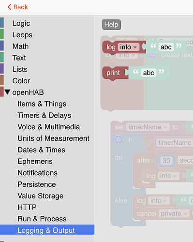

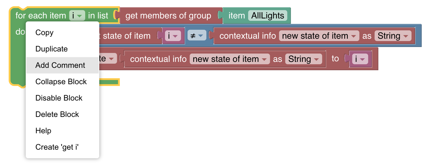

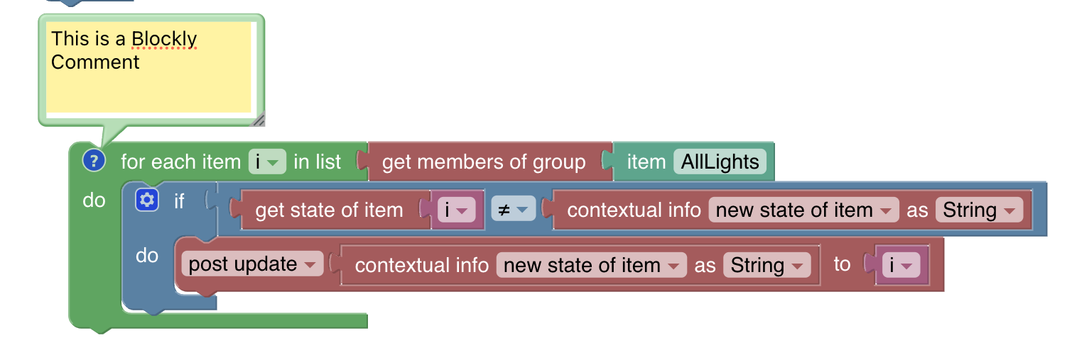

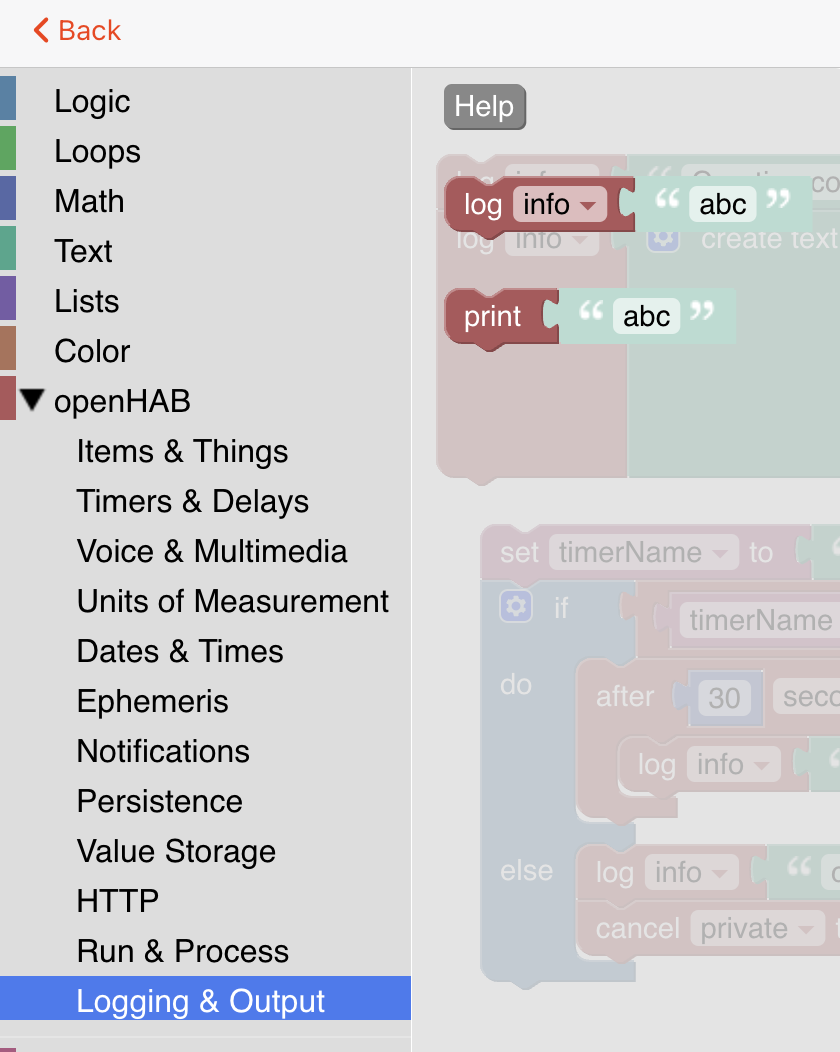

Comments and logging are of course also supported.
// This is a Blockly Comment
