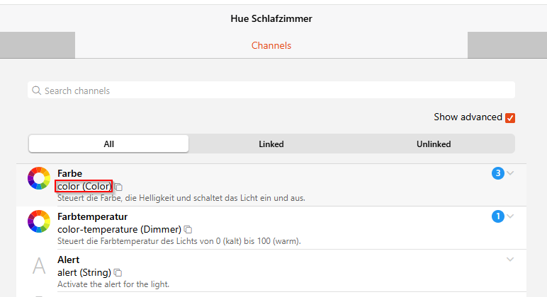

Does your thing actually have a ‘brightness’ channel? If your thing is a color lamp, then it probably has a ‘color’ channel but no ‘brightness’. In that case you send the PercentType command to that channel. Or you can use the ‘dimming-only’ channel.

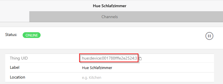

In my opinion both approaches are needed.
Approach 1 for device combined with a color channel
Here the color channel
val hueActions = getActions("hue","hue:device:001788fffe2e2524:3")
val hueActions.dynamicCommand("color", new PercentType(99), Long.valueOf(20000))

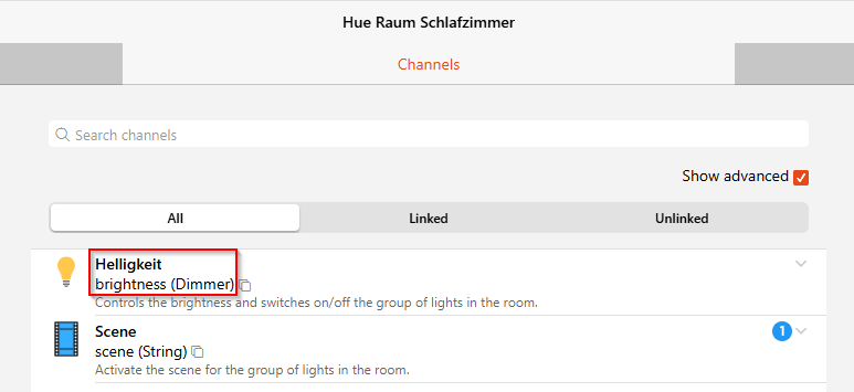

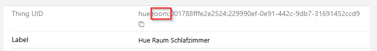

Approach 2 for room combined with a brightness channel
Here the brightness channel.
val hueActions = getActions("hue","hue:room:001788fffe2e2524:229990ef-0e91-442c-9db7-31691452ccd9")
hueActions.dynamicCommand("scene", new StringType("Tropendämmerung"), Long.valueOf(20000))
hueActions.dynamicCommand("brightness", new PercentType(100), Long.valueOf(20000))
Scenes also work with the name/string from OH here the screenshot:
Both room/zone and device things have a variable number of channels. See below. And (obviously) you cannot send commands (neither direct commands nor dynamic commands) to a channel that does not exist in the thing.
