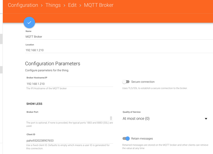

- Issue of the topic: Trouble connecting openHAB to mosquito installed on same Raspberry Pi
Any help would be great, I have mosquito up and running and can connect with Owntracks/phone and MQTTool and observe data flowing. I just can not seem to get openHAB to connect and keep getting the error message below.
At the moment I don’t have any authentication on mosquito and can publish to it via 1883 from LAN & WAN.
I have had a look around but can’t seem to get it working.
Also is there a good link to get Owntracks working (I had it going on 1.x and am moving over to openhabian, yes a bit slow)
