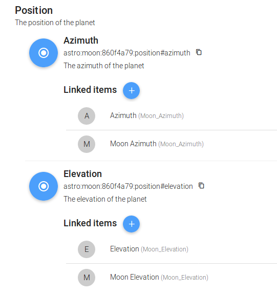

I made the astro data as a thing and I can see I am pulling the data in my PaperUI:
But I encounter the following problems:
- With regard to the sun, I get the Azimuth, the sunrise and the sunset in my application, but NOT the Elevation
- Instead of Sunset and Sunrise as defined in my demo file, it says “Start time” and “Start time”
- I do not get any of the moon data in my application
oddly though it puts the text “name” behind 'Moonphase"
I realize that my item file binds the moon data with: { channel = “astro:moon:home:phase#name” }, whereas my moonbinding says { channel = “astro:moon:local:phase#name” }, but when I change ‘home’ into ‘local’, it has the same effect of not working.

I removed ‘local moon’ and readdded “Astromoon” (do not know the difference. After retrying and retrying the link suddenly the Moon elevation shows up, but for the life of my i cant see what I did different for the Azimuth and moonphase
What am I doing wrong?
