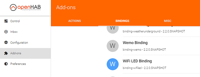

  2. How do I install my selected bindings? When I click on Configuration-> Bindings in the Paper UI nothing happens.

Look under Addons

Great! I removed the .things file, installed the Wemo bindings, and my device was discovered. I will fumble around and see what I can do with it. I am sure I will be back with more questions.
