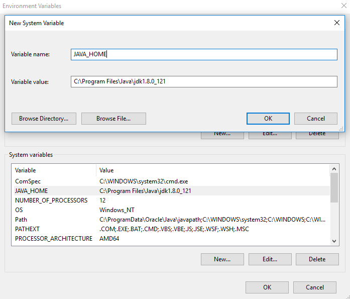

I am trying to follow the install according to the directions on openhab site. where do I find the value to enter for Java home variable?
  • Control Panel :right_arrow: System and Security :right_arrow: System :right_arrow: Advanced System Settings :right_arrow: Environment Variables :right_arrow: System Variables
The value is the file path to the JDK
