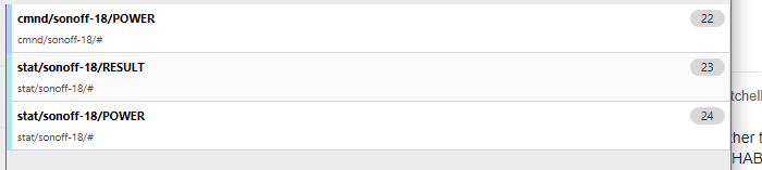

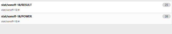

Its a strange one. I use MQTT.fx to see what MQTT messages are sent.
If I turn the sonoff on from the OPENHAB2 UI I get the following messages in MQTT.fx
If I turn the sonoff on from the sonoff UI (press TOGGLE) I get the following in MQTT.cfg
Notice the missing CMND message
cmnd is sent FROM openhab to the Sonoff.
stat is the feedback from the Sonoff TO openhab on its current state.
This is correct behaviour.
As per my first post above, these two things are defined against the Switch item, the “cmnd” is defined as outgoing FROM openhab TO Sonoff via the “>” symbol, and the “stat” is coming INTO openhab FROM the Sonoff.
