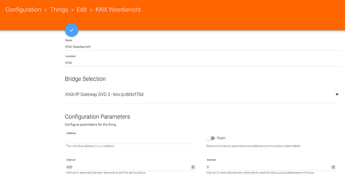

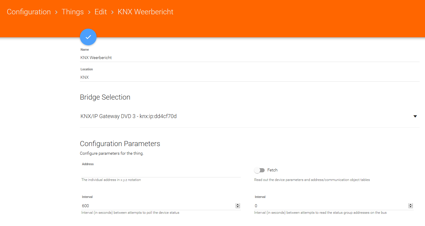

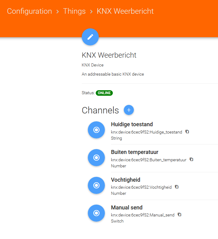

Could you simplify with showing us one Thing , one Number Item that you are trying to work with, and explain what goes wrong and what you can see happening.
Everithing is define within paperUI, there is no *.thing or *.item file

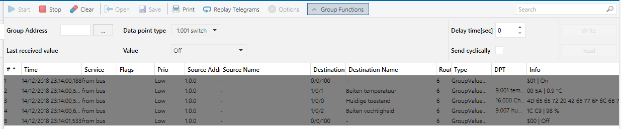

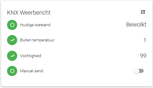

i want to send this value to a knx device (touch screen)

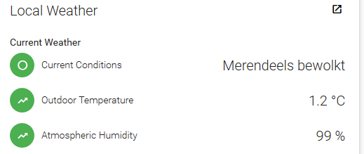

the value is comming from
“Manual Send” is used to force the values to the knx bus

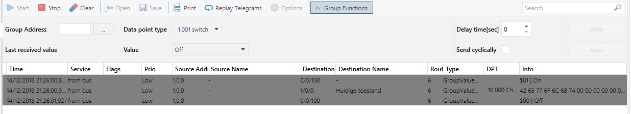

and this wath i see on the knx side

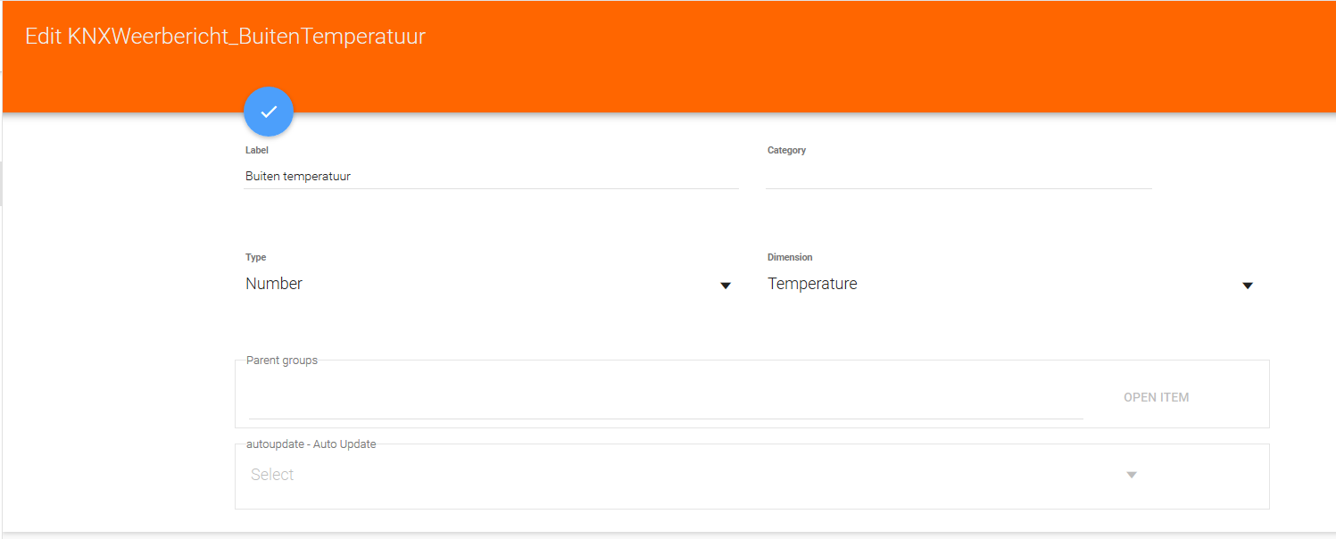

I have found part of the solution, the problem seems to be the conversion of the values.
When converthing xx.state as Number and the put it back var.floatValue
Now i have to find the code to cover a -NAN% in the source value

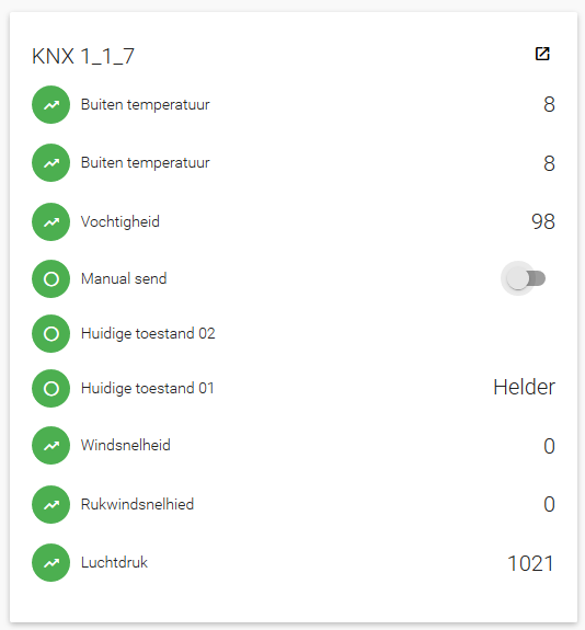

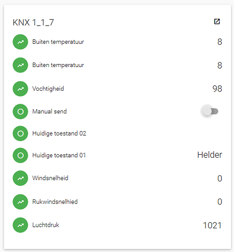

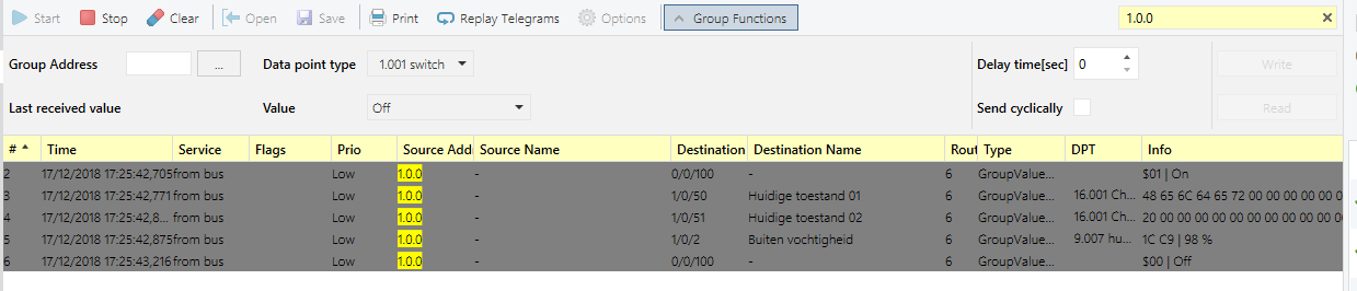

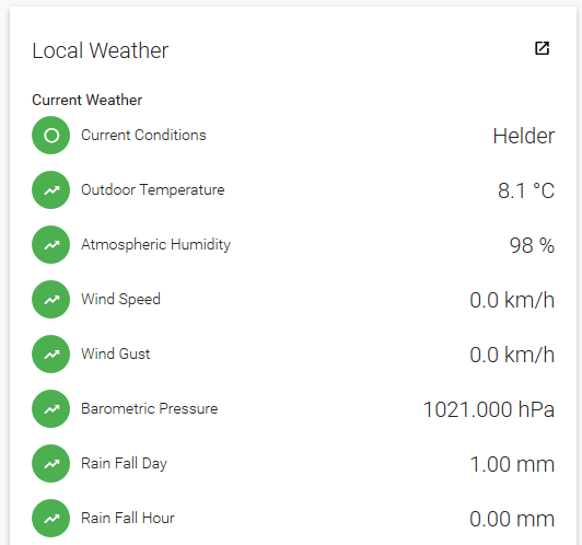

Only 3 of these values are send on the knx bus :
            sendCommand(KNX1_1_7_HuidigeToestand01,LocalWeather_Current_CurrentConditions.state.toString.indexOf(0,13) )
            sendCommand(KNX1_1_7_HuidigeToestand02,LocalWeather_Current_CurrentConditions.state.toString.indexOf(14,lengte10))
            sendCommand(KNXWeerbericht_Vochtigheid,LocalWeather_Current_AtmosphericHumidity.state as Number)
the are updated in the paperUI
destination
Soure
and not on the knx bus
some one any idee what to check now

here i found out that indexOf(x,y) has to be substring(x,y)
Weer11=LocalWeather_Current_CurrentConditions.state.toString.substring(13,26)
