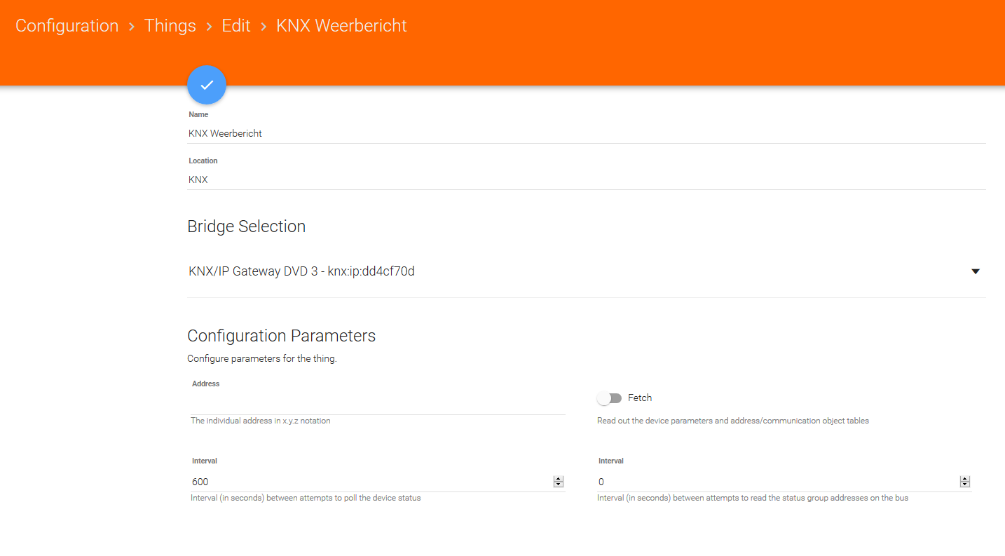

I have created a KNX thing white the used KNX groups

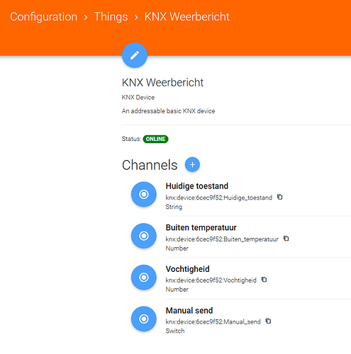

The ‘Manual Send’ have group adres 0/0/100 and is send on the KNX bus (item type = switch)
the ‘Buiten temperatuur’ have group adres 1/0/1 and is not send to the KNX bus (item type = number)

the configuration of the knx devices is don i the paperUI

below the item config in paperUI
and the code in org.eclipse.smarthome.core.items.item.json

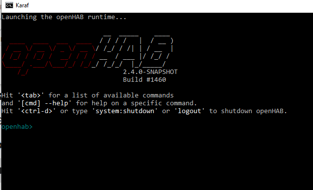

karaf console message
SLF4J: Failed toString() invocation on an object of type [org.eclipse.smarthome.core.items.events.ItemStateChangedEvent]
Reported exception:
java.lang.OutOfMemoryError: Java heap space

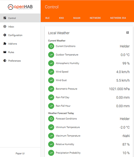

i used weather underground information
when i use postUpdate, the paperUI ‘KNX weerbericht’ will display the same values
I have removed ‘Log ReaderBinding’ thing, removed the ‘Bleutooth Binding 2.4.0’ and ‘CometVisu Backend 2.4.0 UI’ form my configuration.
Now Karaf is quit
I will now try the rule again

My ‘KNX weerbericht’ is not a fysciale knx hardware device but a virtual openhab KNX device, so i dont have a fysical knx adres for it.
When i put heer a non existhing device adres, the the thing go to off line.
I now have adde the rules again

in paperUi the KNX Weerbericht items are updated

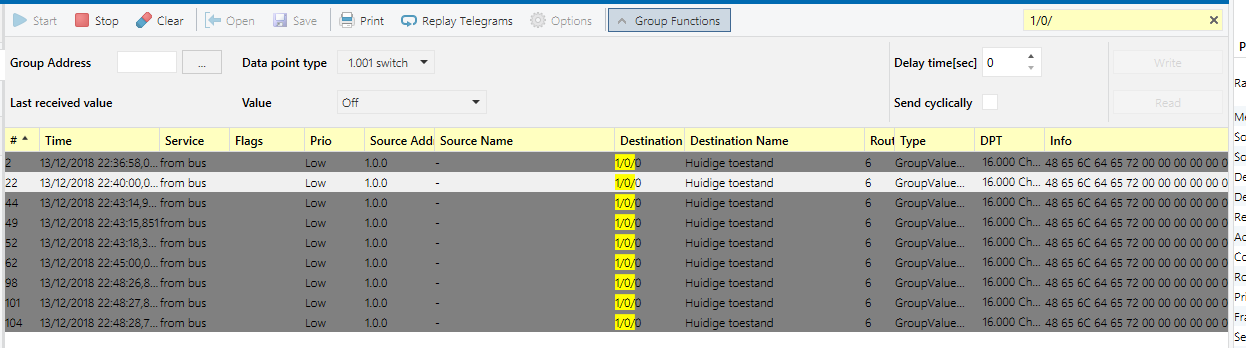

in the KNX monitoring i only see the ‘Manual send’
‘Huidige toestand’ = 1/0/0 Type = String
‘Buiten temperatuur’ = 1/0/1 Type = Number
‘Vochtigheid’ = 1/0/2 Type = Number
all my other knx things and items are still working, so the bindinsg a disabled are the blocking part for the knx binding !?
Ok there more comming on the KNX bus, Sting is send on the bus, now the Numbers ti get it to work
