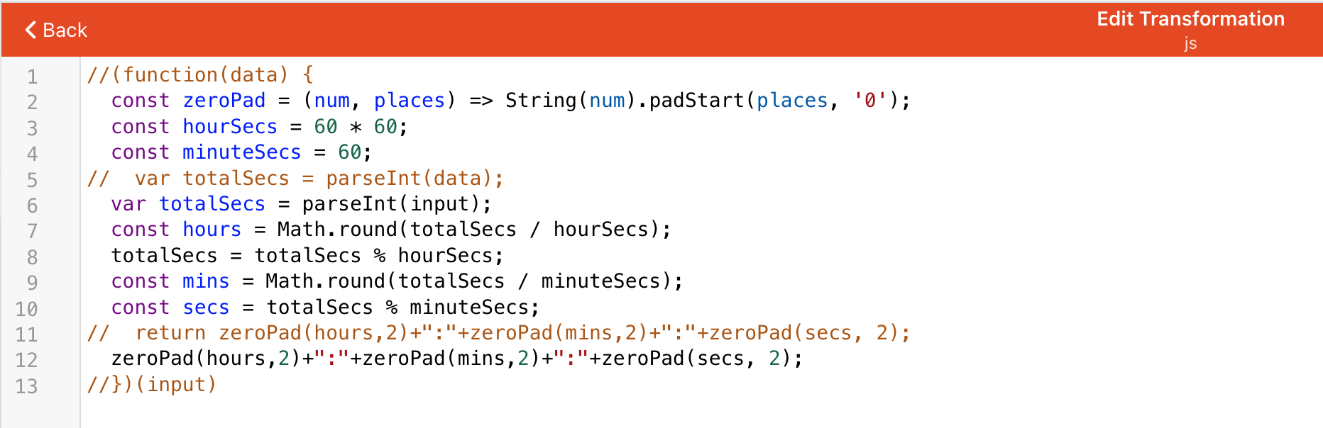

Since OH 4 you can define the transform through the UI. You don’t need any files.
I also showed above how you could use an inline JS script which doesn’t require any file nor does it require defining it through the UI.
I’m not saying you should change because what you’ve done is perfectly acceptable. But the Script transform can be just as “clean”.

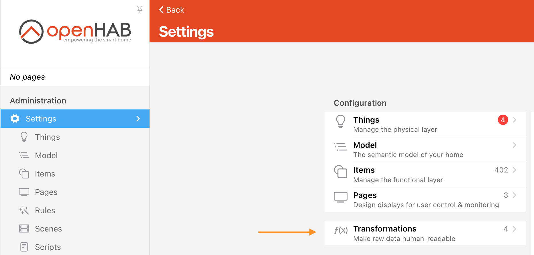

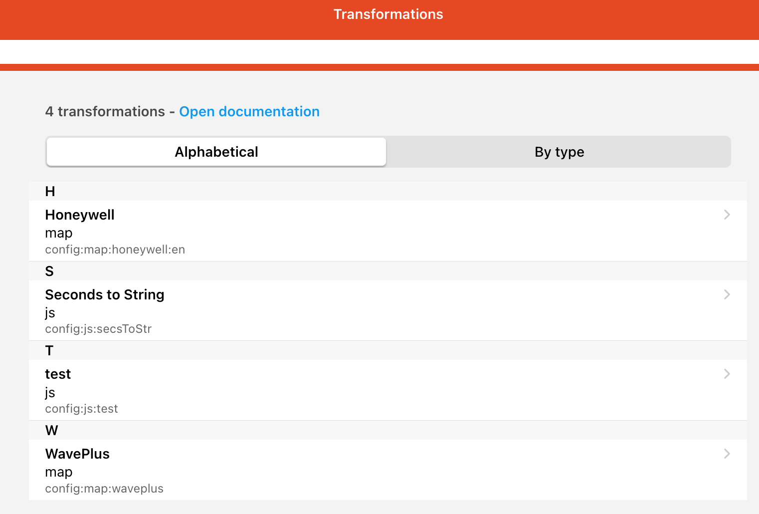

Interesting, are you referring to Profile and Profile configuration part?
Settings → Transformations
