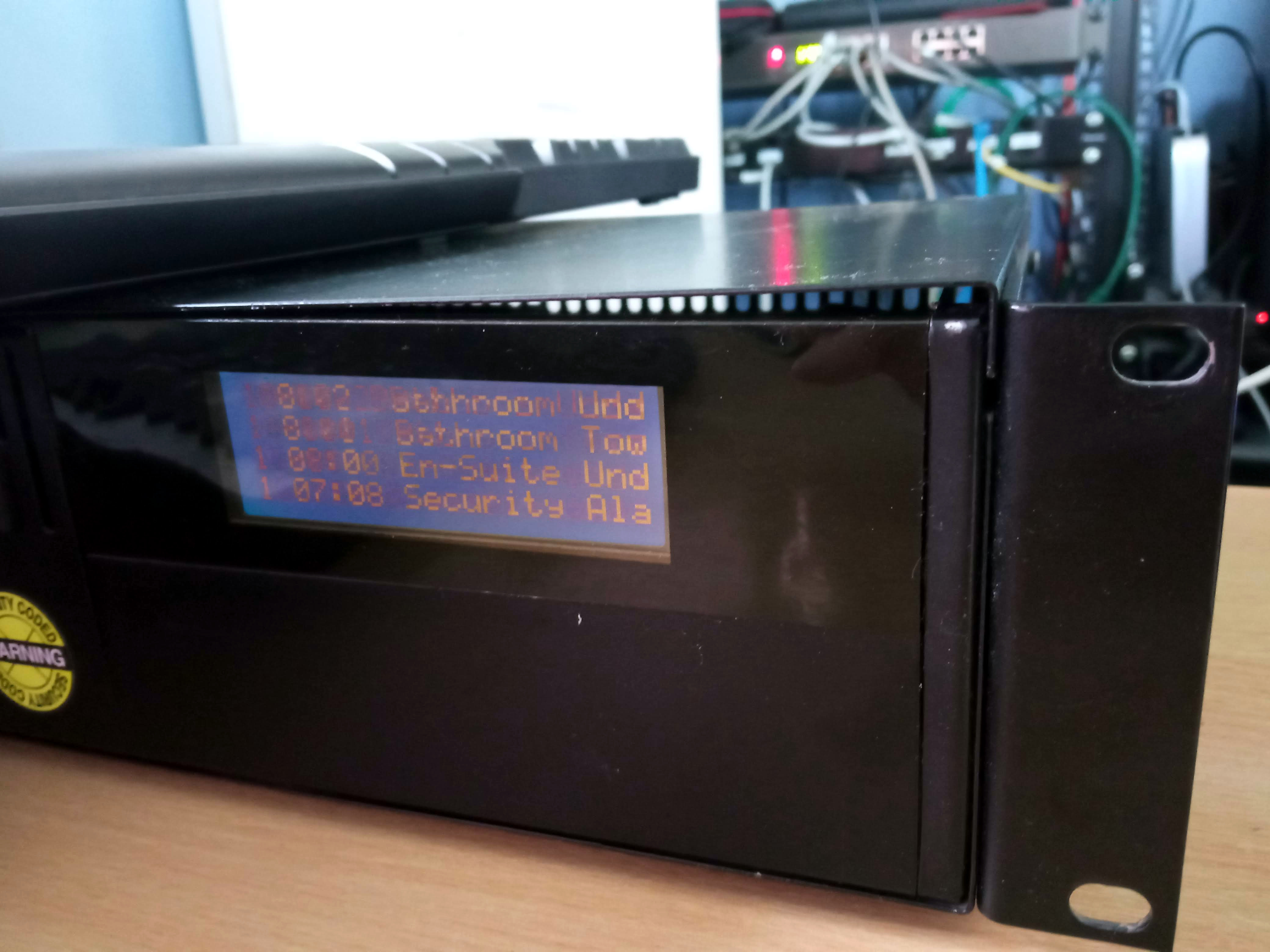

All set-up now, text scrolling my house events from openHAB :grinning:

IMG_20210121_090115
