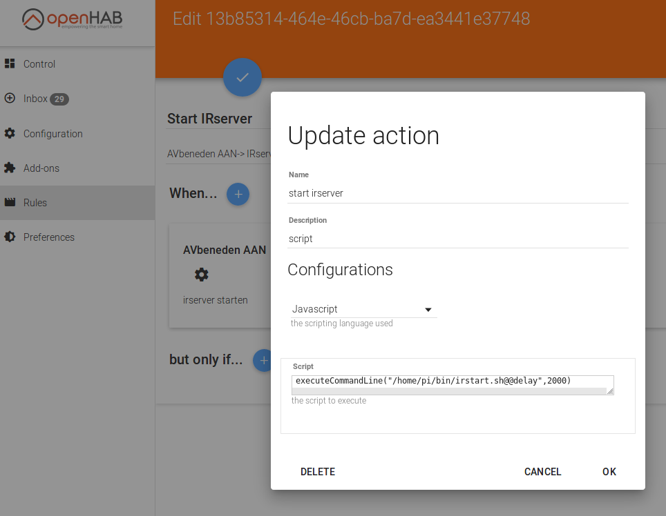

I can’t run a shell script. In log message:
Script execution failed: ReferenceError: “executeCommandLine” is not defined in at line number 1

sorry, that document is not helpfull. i’ve discovered, when i copy the old (oh1) xyz.rules file to /etc/openhap2/rules, it seems to work. without the ‘rubbish’ in the ‘rules gui’.
i have no idea how to use the ‘gui’ for this type of actions. i’ve found my ‘xyz.rules’ in the ‘gui’ but i can’t edit it. although the file and directory are ‘writeable’ (for everybody)
the ‘gui’ is a big mystory for me :sad_but_relieved_face:
I think maybe “rules gui” is referring to the experimental rules engine? This does its own thing, completely unrelated to rules in xxx.rules files. Like it says, it’s experimental and has limitations. I think what you were telling it to do was to execute a script called executeCommandLine, which I shouldn’t think you had in your scripts folder. I have no idea how you would get it to run an actual script, if that’s currently possible.

About the ‘rules gui’, i mean the ‘editor’ like the attached screenshot at the start of this thread. That ‘jigsaw piece’ editor in habmin is pure horror.
