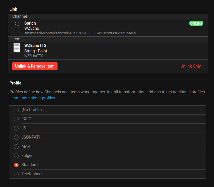

Yes like this:
I don’t have something like this:
Where come this text from? This looks like an item. I don’t have this in my item…

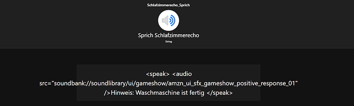

when I trigger the rule, it appears for a short time…I secreenshotted right after i pressed play to test the rule…normally this field is empty…I just switched on the semantic-tag point and none (like yours instead of emty) still nothing…
The only difference I have in my item is the symbol, and the profile (which was none for me). I switched it to standard, but still don’t hear anything…
