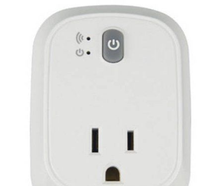

Turn a cheap WiFi plug into an OpenHAB ESP8266 switchable plug
Hey folks I just posted a tutorial on hacking a cheap wifi plug with ESP Easy
Nice! I did the same thing with my two pack of Eco Plugs. Really kicking myself for not getting more when they were on sale. Have you come across any others besides the Eco Plugs and the WorkChoice that use the ESP8266?
I also have the physical button on the plug working with a few ESPEasy rules. I can share if you’d like.
