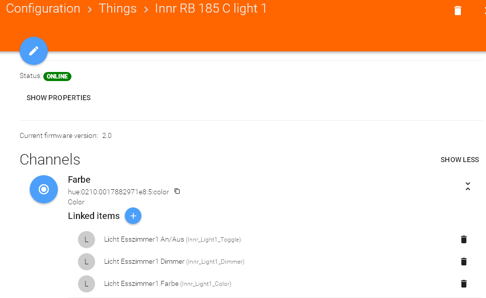

Then please goto PaperUI → Configuration → Things → Your Hue Color Bulb → Configure → goto the color channel → then click on the link button (on the right side) Then you should see at least your linked items.
You need min. 3 linked items (Switch/Toggle, Dimmer, Color) !! (In my example above “Licht Esszimmer1 An/Aus (Innr_Light1_Toggle)” is configured as type: Switch
Pease identify your item which is configured as switch! If you do not have anyone, please ADD it there. Then you have to use this item in your rule.
For above shown example it looks like:

Yeeeaaaahh yipie yeah … IT WORKED!
Thanks alot!
There were two problems:
  • there was no ITEM “SWITCH” - I applied it now manually (after turning off the “simple mode” in the ITEM LINKING)
  • there was a bug in mein rule:
    => wrong: Innr_Light1_Toggle.state== “ON”
    => right: Innr_Light1_Toggle.state==ON
@Celaeno1 - Vielen Dank aus Stuttgart für die Hilfe und Mühe
Tom
