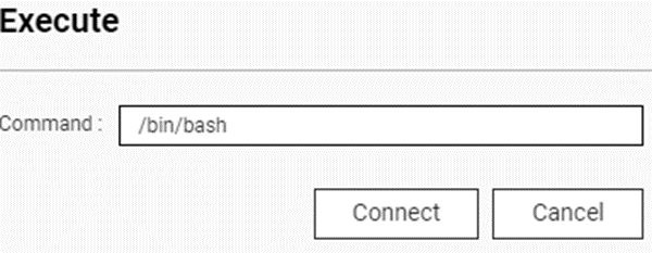

I found out that most OpenHAB Docker versions don’t have a shell on board and therefore the shell commands from the exec binding are not executed.
If I run the terminal command /bin/bash in the Qnap NAS, in the container station, in the Openhab container, a browser window with terminal input opens.
When I try ssh there I get command not found as an answer.
So if it really is the case that there is no shell in Docker, how can I install one?
