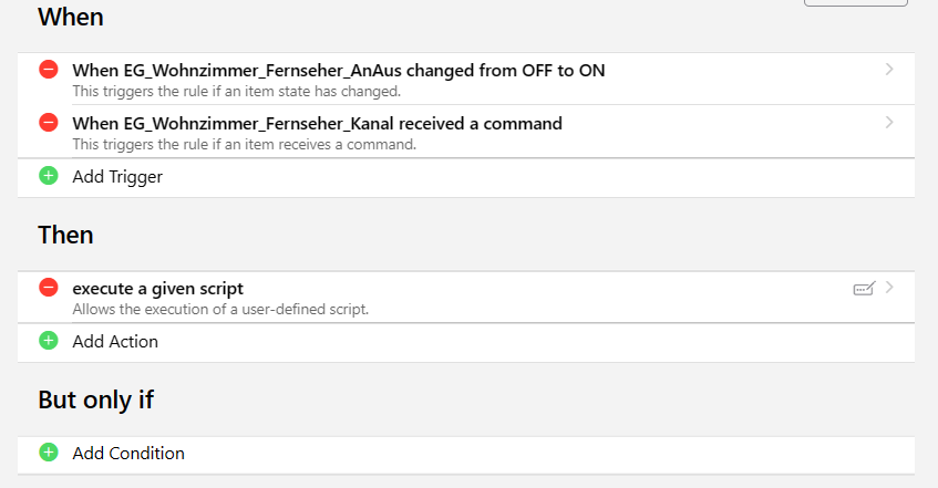

I control my TV 99% of the time via voice assistant and always was annoyed that I need to issue two commands:
- Turn TV on
- Select the correct channel I want to watch
Therefore I created the rule below to automatically turn on the TV once the channel items receives a command. Once this rule is setup I only need to choose a specific channel and TV will automatically turn on and switch to the correct channel
Tested with OH4.0.4 & LG WebOS binding
Prerequisite:
- Disable auto-update of power item via meta-data
- Power item as switch
- Channel item as string

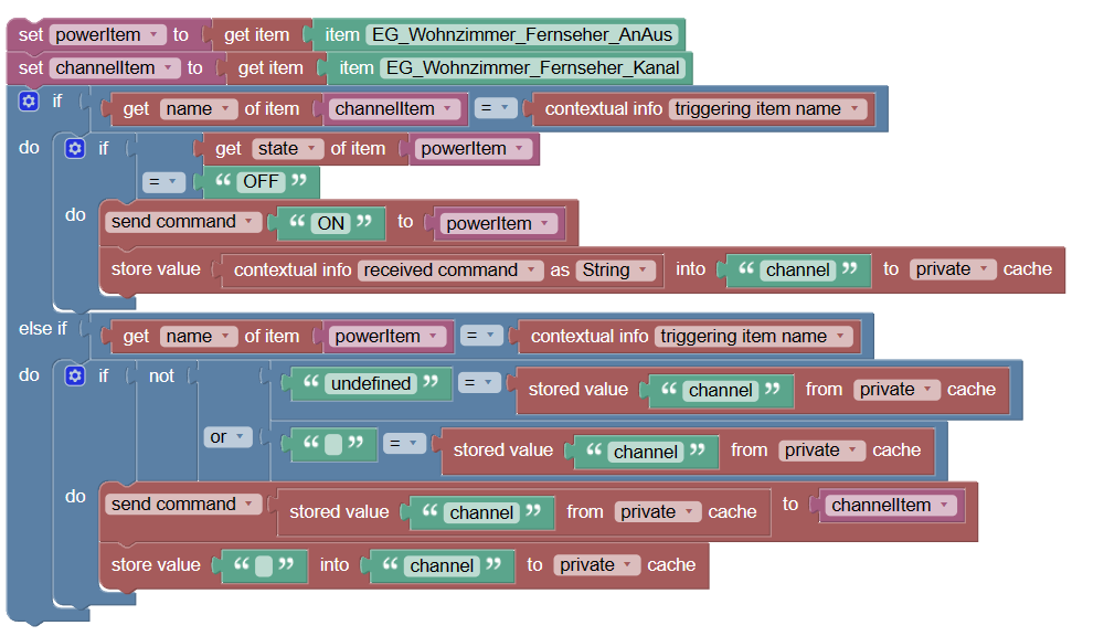

Steps to do:
- Copy rule to your system
- Replace power & channel items within the rule triggers with your specific items
- Open the blockly rule and replace power & channel items at top with your specific items
- Have fun
Rule Code

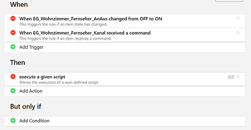

configuration: {}
triggers:
- id: "2"
configuration:
itemName: EG_Wohnzimmer_Fernseher_AnAus
state: ON
previousState: OFF
- id: "3"
configuration:
itemName: EG_Wohnzimmer_Fernseher_Kanal
type: core.ItemCommandTrigger
conditions: []

type: application/javascript
script: >
var powerItem, channelItem;
powerItem = items.getItem('EG_Wohnzimmer_Fernseher_AnAus');
channelItem = items.getItem('EG_Wohnzimmer_Fernseher_Kanal');
if (channelItem.name == event.itemName) {
if (powerItem.state == 'OFF') {
powerItem.sendCommand('ON');
cache.private.put('channel', event.itemCommand.toString());
} else if (powerItem.name == event.itemName) {
if (!('undefined' == (cache.private.get('channel')) || '' == (cache.private.get('channel')))) {
channelItem.sendCommand((cache.private.get('channel')));
cache.private.put('channel', '');
type: script.ScriptAction
