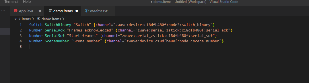

I am looking for someone who may have an example of what I need to do. I am using VS code and want to turn on a plug from an exteral app that I have created with a GUI. I imported the cfg workspace and have the items in here, what I need to know is how do I access them and turn the switch on with the java code? Is there a way to import them to the java program or is there something else I need to do? For now I just want to run the code in the main program to just turn on the switch.
