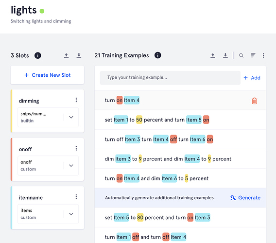

There is one Intent in this app which is the light intent. If you fork it you can edit it to see its structure and adapt it to your system.
You can see it has 3 Slot Types. One for dimming, one for switch values and one for Item names.
You need to edit the one for the names:
In the value column you have to insert your Openhab Item Names you want to Switch as Snips can only know words and names you explicitly teach the model. Into the right column you can put synonyms for those Items which need to be separated by a comma.
As a next Step you have to use those Names in the model sentences on the first page of the intent. You will have to substitute Item 1, Item2 etc with your Items and synonyms and mark them as type itemname. The more examples you write the better your local model will be. Once you adapted the itemname slot and have rewritten the training sentences you can save it and try if it works on the right side of the console. Type in a sentence and you will see what snips understands in the json output:
This is very similar to what Snips will send over Mqtt.
