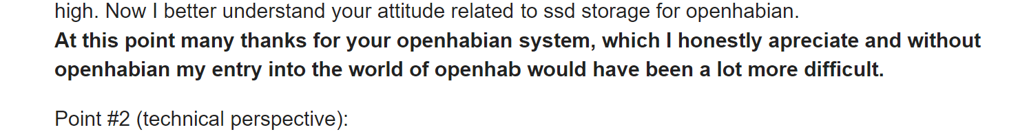

I think I can speak for everybody here who uses openHABian, that we are all really thankful for markus’ and ethan’s work. No doubt about it.
In the thread markus mentioned above I clearly stated this, too, a few days ago
Unfortunately all posts go into the wrong direction because of taking something “personal” (why?) or not reading what I have written or what my intention is.
