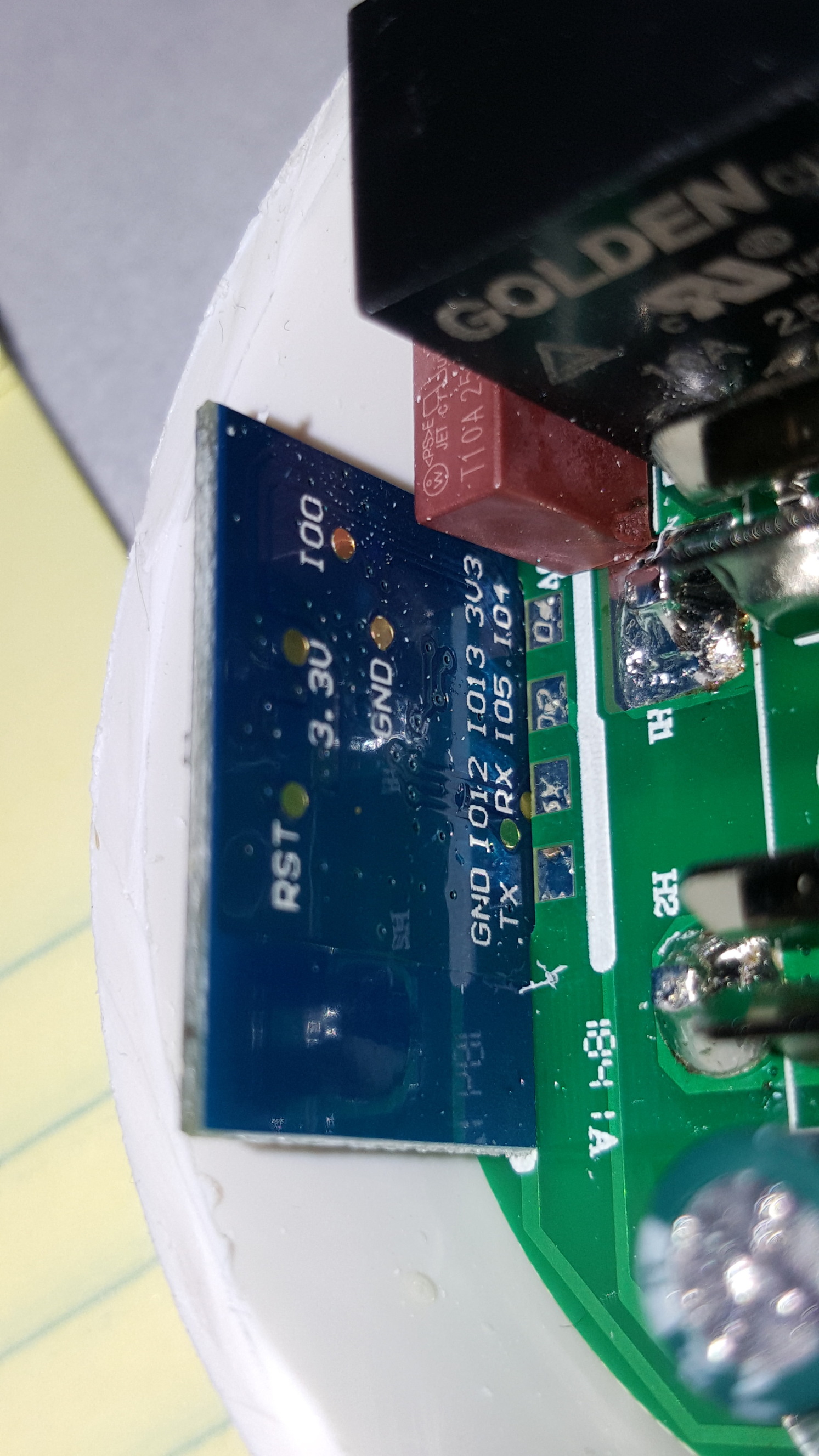

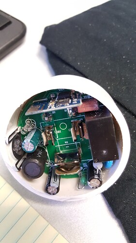

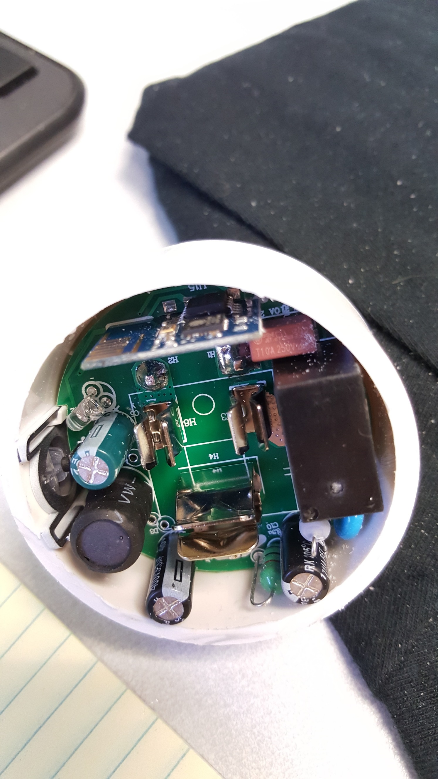

I bought a pair of the Mini Smart Sockets and decided to open one up.
It has the ESP8266EX processor like the SONOFF boards and could be very FIXABLE!
Inside the plug
the micro board
I hope to figure out a better way of opening it (We cut the top off)
It can be glued back together, but won’t be very pretty.
