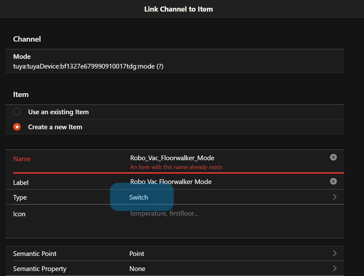

Pre-Analysis

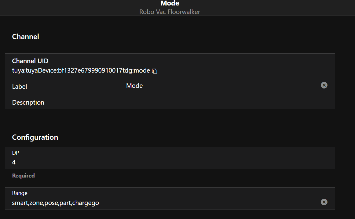

I looked into the channel mode
There’s a range with some options defined (fine) DP I don’t know
If I want to attach an item the suggestion is Switch
Seems this isn’t matching!
If you can place some hints for me I can modify and build the binding and perform tests!
