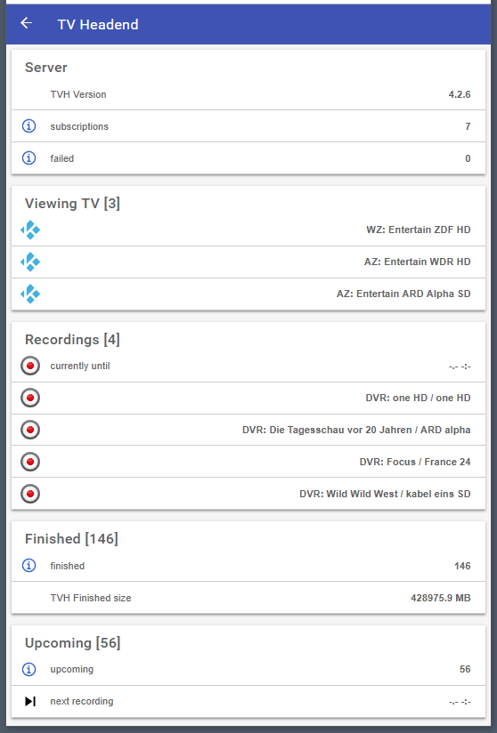

TVHeadend is a TV streaming server and recorder for Linux, FreeBSD and Android supporting DVB-S, DVB-S2, DVB-C, DVB-T, ATSC, ISDB-T, IPTV, SAT>IP and HDHomeRun as input sources.
I am using TVHeadend with a single IPTV provider (EntertainTV, Deutsche Telekom), running on Ubuntu 16.04 LTS Server. I use the EPG of www.epgdata.com, a payed provider.
The ease of use with Kodi as a client leaves my two proprietary tv receiver almost unused, although just a limited set of programs is available on unencrypted iptv. (Didnât start one of those receiver up this year, and itâs already February.)
Currently connected are three RaspberryPi 3 and one Pi 2Vero 4k, all of them running with LibreElec osmc. Optionally a connection is be made from Kodi running on Windows 10 on a PC.
TVHeadend provides a JSON API to interfere with, so today i started some basic integration of TVHeadend into openHAB. The integration is done via http binding, JSON Exec binding, curl, jq and JavaScript transformations and rules. You still need the Jsonpath transformation for some of the rules.
Known bugs
- i just discovered the two time items do not work anymore. (recordings until / next recording start). These will be fixed sometime
Features
- show TVHeadend release (no use, really
) - current subscriptions (am i allowed to restart tvheadend server?)
- count & size of finished recordings (do i need to clean up the recordings?)
- messaging if a recording is failed or finished (should i have cleaned up the recordings)
- show the latest finish of the current recordings
- show the earliest start of the upcoming recordings
Changes
- no more cron trigger, every change is resolved via http binding
- optimized items, no more extreme large strings
- corrected the size of the recordings, just the 50 first were counted
- added latest current & earliest upcoming recording timestamp
- completely removed http binding and jsonpath transformation from the items, everything is resolved with the exec binding
- split subscritions into recordings & live tv

Sitemap fragment
As before, to increase the number of subscriptions visible to more than 5, add more descriptions with visibility.
Frame label="TV Headend"
Text label="TV Headend" icon="tvheadend"
Frame label="Server"
Text item=TVHE_VERSION label="TVH Version [%s]" icon="tvheadend"
Text item=TVHE_SUBSCRIPTIONS_COUNT
Text item=TVHE_FAILED_COUNT
Frame item=TVHE_LIVETV_COUNT label="Viewing TV [%s]" visibility=[TVHE_LIVETV_0_VISIBLE==ON,TVHE_LIVETV_1_VISIBLE==ON,TVHE_LIVETV_2_VISIBLE==ON,TVHE_LIVETV_3_VISIBLE==ON,TVHE_LIVETV_4_VISIBLE==ON]
Text item=TVHE_LIVETV_0_DESCRIPTION icon="kodi" visibility=[TVHE_LIVETV_0_VISIBLE==ON]
Text item=TVHE_LIVETV_1_DESCRIPTION icon="kodi" visibility=[TVHE_LIVETV_1_VISIBLE==ON]
Text item=TVHE_LIVETV_2_DESCRIPTION icon="kodi" visibility=[TVHE_LIVETV_2_VISIBLE==ON]
Text item=TVHE_LIVETV_3_DESCRIPTION icon="kodi" visibility=[TVHE_LIVETV_3_VISIBLE==ON]
Text item=TVHE_LIVETV_4_DESCRIPTION icon="kodi" visibility=[TVHE_LIVETV_4_VISIBLE==ON]
Frame item=TVHE_RECORDING_COUNT label="Recordings [%s]" visibility=[TVHE_RECORDING_0_VISIBLE==ON,TVHE_RECORDING_1_VISIBLE==ON,TVHE_RECORDING_2_VISIBLE==ON,TVHE_RECORDING_3_VISIBLE==ON,TVHE_RECORDING_4_VISIBLE==ON]
Text item=TVHE_UPCOMING_CURR_STOP visibility=[TVHE_RECORDING_0_VISIBLE==ON]
Text item=TVHE_RECORDING_0_DESCRIPTION icon="record" visibility=[TVHE_RECORDING_0_VISIBLE==ON]
Text item=TVHE_RECORDING_1_DESCRIPTION icon="record" visibility=[TVHE_RECORDING_1_VISIBLE==ON]
Text item=TVHE_RECORDING_2_DESCRIPTION icon="record" visibility=[TVHE_RECORDING_2_VISIBLE==ON]
Text item=TVHE_RECORDING_3_DESCRIPTION icon="record" visibility=[TVHE_RECORDING_3_VISIBLE==ON]
Text item=TVHE_RECORDING_4_DESCRIPTION icon="record" visibility=[TVHE_RECORDING_4_VISIBLE==ON]
Frame item=TVHE_FINISHED_COUNT label="Finished [%s]" visibility=[TVHE_FINISHED_COUNT!="0"]
Text item=TVHE_FINISHED_COUNT
Text item=TVHE_FINISHED_SIZE
Frame item=TVHE_UPCOMING_COUNT label="Upcoming [%s]" visibility=[TVHE_UPCOMING_COUNT!="0"]
Text item=TVHE_UPCOMING_COUNT
Text item=TVHE_UPCOMING_NEXT_START
Frame item=TVHE_FAILED_COUNT label="Failed [%s]" visibility=[TVHE_FAILED_COUNT!="0"]
Comments & ideas welcome
Please feel free to add your comments or ideas. ![]()
