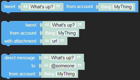

This library adds blocks to use the Twitter actions allowing to send tweets with or without attachments, as well as direct messages. You need the Twitter binding installed and properly configured.
Blocks
Send a simple tweet.
Send a tweet with an attachment.
Proof it works: :wink: : https://twitter.com/yschaus/status/1470124826069192704
Send a direct message.
