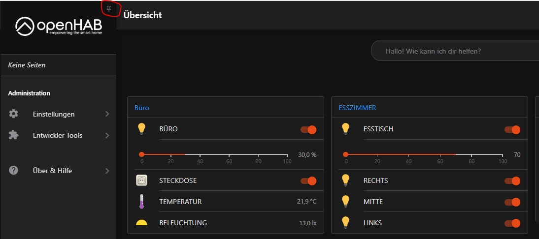

Two Problems with OH3: Hide sidebar when "pages" are activated and "icons" not visible on pages
Is there an option to switch off the sidebar on the left? In screenshots I see some times that it should work, but I can’t finde a option that works for me.
On my 10 "tab, which I hang on the wall as a control unit, that’s a waste of space.

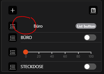

I also don’t see icons that I assign to a function of a widget. Do I have to enter a path there?

For icons you need oh:“icon name” it tells you just below where you put the icon name

In addition to hint to use oh:lightbulb (or is it just oh:light, I don’t remember which) you will want to click the “Show Advanced” checkbox and there is a switch to “Icon uses Item State” or something like that if you want to have dynamic icons.

Even I was struggling to hide the left bar completely on the ipad safari browser and then realized there probably isn’t an option.
I think it will be a nice feature addition to be able to hide the bar for using as a display UI (as opposed to just having it there without the menu items)
You can always file an issue. But my understanding and expectation is if one is logged in as an administrator, the menus should be shown. You need those menus to administer the installation. If you only want to see the stuff to control your home automation, you should log in as a non-administrator user. That’s kind of the whole point of the role based authentication.

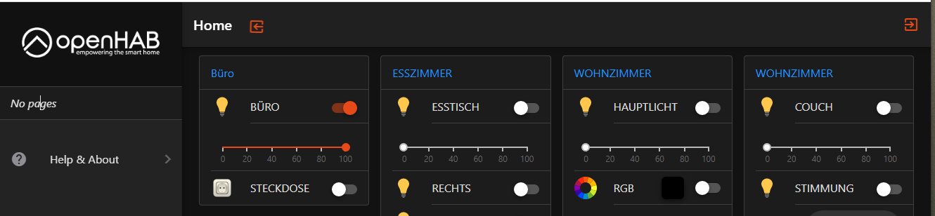

The sidebar can be freed from the buttons with the user, but I see it like Candiesdoodle. Especially on a small 10 "screen that I just want to operate on, it’s a shame about the 20% that is lost here.

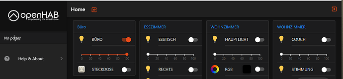

I would like to have a button in the top left of the header, analogous to the one at the top right (Other Apps) with which you can hide / show the entire menu.
Maybe like that:

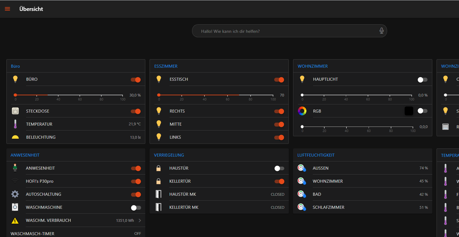

There is basically the option, on the mobile phone it is also automatically hidden and you can display it again with the three lines symbol.
Even if you push the browser window together, the menu disappears and the symbol appears. So it shouldn’t be a big effort to make it permanent.
