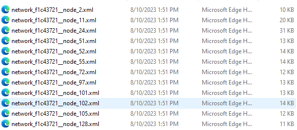

Could be I do not understand. Look at the zwave folder for example
The hex string of the network is f1c43721 and only 232 nodes can be on that network. Does your second controller have the same hex string as the first controller in the zwave folder? If it is different then you should be okay to exceed 232, but it is beyond my understanding how this works.
