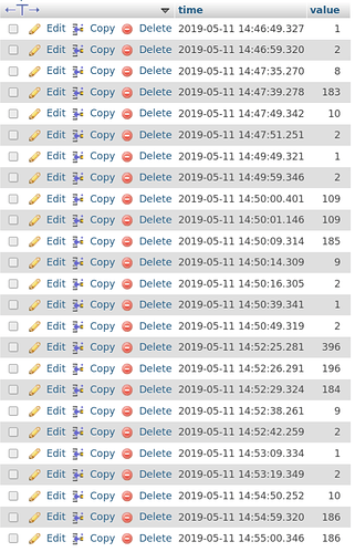

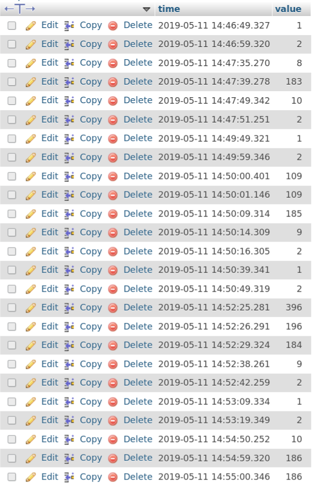

jdbc is selected as default persistence service.
Droger_watt persistence using jdbc with mariadb:
The database gets filled, so why is Droger_watt.averageSince(now.minusMinutes(2)) as Number always returned as null?

Ok, now we know for sure that the call is in fact returning null. Unfortunately, type errors also generate a null error so tested like this have to be performed to tell the difference.
Since you’ve shown that data is in the database all I can recommend is to for an issue. See How to file an Issue.
I think this would be in the core but I’m not positive.
OK thanks, I’ll open an issue in core.
Which persistence do you use? jdbc or mariadb? Did you setup the persistence service as default persistence service yet?
I use JDBC, which stores it data in a mariadb:

That test wasn’t valid :slightly_frowning_face:. When an Item’s state hasn’t changed, averageSince will return null because there is no persisted data within that time interval. I misspoke before, because persistence is not in openhab-core, but we’re talking about PersistenceExtensions which are. So your issue is in the right repo to request that the current value be included in averageSince. After a brief look at the code, I believe this functionality could be added by simply changing this line to return the current value instead of null.
Your rule is triggering on change, so you’d expect that this wouldn’t be an issue, but persistence takes some time after a change to write to the database. So it is possible that the value has not been persisted before the commands in the rule are executed. Based on your persistence data, this could occasionally be making the interval since the last change larger than 2 minutes and causing the error. I think it would be better to use maximumSince, because it does not return null if the Item hasn’t changed. Although, if you really want to use averageSince, you could try changing the interval to 3 minutes or add an every1Minute strategy. In either case, you should add handling of null values.
For our power monitoring rules, I use a timer for debouncing the values (no persistence needed).
I did some additional testing (specifically specify jdbc and change 2 to 3 minutes):
rule "Droger Consumption State Machine"
    Item Droger_watt changed
    if ((Droger_watt.averageSince(now.minusMinutes(3), "jdbc")as Number) == null) {
      logWarn("Rules", "Test: Start")
      logWarn("Rules", "lastUpdate [{}]", Droger_watt.lastUpdate)
      logWarn("Rules", "changedSince [{}]", Droger_watt.changedSince(now.minusMinutes(5), "jdbc"))
      logWarn("Rules", "averageSince [{}]", Droger_watt.averageSince(now.minusMinutes(5), "jdbc"))
      logWarn("Rules", "Test: End")
    return;
    //val Number nAvg = Droger_watt.averageSince(now.minusMinutes(3)) as Number
    //logInfo("nAvg value", "nAvg" + nAvg)
    if (((Droger_watt.averageSince(now.minusMinutes(3), "jdbc")) as Number) < 1) {
        //logInfo("Verbruik", "Droger watt = " + Droger_watt.averageSince(now.minusMinutes(3)) + PowerAverage)
        logInfo("Verbruik", "Droger watt = " + (Droger_watt.averageSince(now.minusMinutes(3), "jdbc") as Number))
        logInfo("Verbruik", "1 Drogerstatus = " + Droger_Status.state + " " + Droger_watt.averageSince(now.minusMinutes(3), "jdbc") + " " + Droger_watt.state)
        Droger_Status.postUpdate(MODE_OFF)
    else if ((Droger_watt.averageSince(now.minusMinutes(3), "jdbc") as Number) > 100) {
        logInfo("Verbruik", "2 Drogerstatus = " + Droger_Status.state)
        Droger_Status.postUpdate(MODE_ACTIVE)
    else if ((Droger_watt.averageSince(now.minusMinutes(3), "jdbc") as Number) < 3) {
        logInfo("Verbruik", "3 Drogerstatus = " + Droger_Status.state)
            if (Droger_Status.state == MODE_OFF) {
                Droger_Status.postUpdate(MODE_STANDBY)
                logInfo("Verbruik", "4 Drogerstatus = " + Droger_Status.state)
            } else if (Droger_Status.state == MODE_ACTIVE) {
                Droger_Status.postUpdate(MODE_FINISHED)
                logInfo("Verbruik", "5 Drogerstatus = " + Droger_Status.state)
Still failure:
2019-05-14 17:31:55.870 [WARN ] [eclipse.smarthome.model.script.Rules] - Test: Start
2019-05-14 17:31:55.877 [WARN ] [eclipse.smarthome.model.script.Rules] - lastUpdate [2019-05-14T15:31:55.844+02:00]
2019-05-14 17:31:55.888 [WARN ] [eclipse.smarthome.model.script.Rules] - changedSince [false]
2019-05-14 17:31:55.895 [WARN ] [eclipse.smarthome.model.script.Rules] - averageSince [{}]
2019-05-14 17:31:55.898 [WARN ] [eclipse.smarthome.model.script.Rules] - Test: End
When I change my persistence to RRD4J it works:
2019-05-14 17:32:07.727 [WARN ] [eclipse.smarthome.model.script.Rules] - Test: Start
2019-05-14 17:32:07.744 [WARN ] [eclipse.smarthome.model.script.Rules] - lastUpdate [2019-05-14T17:32:00.000+02:00]
2019-05-14 17:32:07.776 [WARN ] [eclipse.smarthome.model.script.Rules] - changedSince [true]
2019-05-14 17:32:07.790 [WARN ] [eclipse.smarthome.model.script.Rules] - averageSince [0.8072691558751039]
2019-05-14 17:32:07.796 [WARN ] [eclipse.smarthome.model.script.Rules] - Test: End
What I do notice now:
jdbc: 2019-05-14 17:31:55.877 - lastUpdate [2019-05-14T15:31:55.844+02:00]
rrd4j: 2019-05-14 17:32:07.727 - lastUpdate [2019-05-14T17:32:00.000+02:00]
Should i read the +02:00 as this time is displayed with an +2 hour offset, or as this time should add +2 hour offset? If jdbc is incorrect, could this be causing the averageSince to fail?
The +02:00 is the UTC offset… your time is 2 hours later than UTC, so subtract 2 from your local time to get UTC.
This could absolutely be causing averageSince to return null. Since the log entry shows the correct offset, it looks like your database is using system time and the clock is set to the wrong time. I would just go check that, but if you want to dig deeper, on the server running MariaDB, run…
mysql -u root -p
show GLOBAL VARIABLES like 'time_zone';
If time_zone comes up as SYSTEM, your system clock is incorrect. If it comes up as something other than your timezone or SYSTEM, you’ll need to find out how/where it got changed and correct it.
Yep that did the trick. Apparently LXC containers default to the UTC timezone. I never noticed. I changed the default profile to use my timezone, reset the timezone on all my containers, removed rrd4j persistence and issue resolved:
