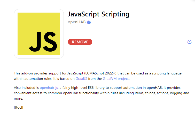

I am running OH4.3 and I have installed:
The script itself is defined asECMAScript (ECMAScript 262 Edition1 11)
