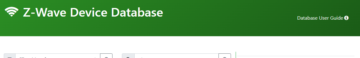

https://opensmarthouse.org/blog/zwave_device_database_guide
There’s a link to this page at the top right of the device list.
Thanks! I was working off of the list linked from the z-wave binding page in the add-ons documentation. Strange that that page doesn’t link to the one you posted.

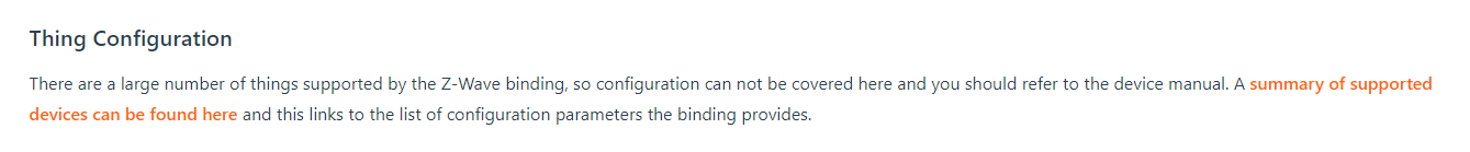

It’s hard to tell what you’re describing. Links and screenshots are your friend. :wink:
Are you talking about these links on this page?
I suspect that the Z-Wave documentation is a little out of date, but I’m not very familiar with it. I don’t know how the Things Supported by the Z-Wave Binding page is updated.
Yes, that’s what I was looking at. Sorry for my lack of clarity. I was writing while making dinner for my family… Probably should have just waited until I had time to sit down and be thorough!

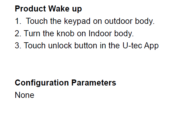

I could not believe that there are no configuration parameters, but the “Ultraloq U-Bolt Z-Wave.
Z-Wave Specification Manual V1.2” indeed states:
The Z-Wave Specification Manual has been uploaded to the Z-Wave database.
Thanks, guys.
I added the Lifeline Association. And yeah, very little to configure, or even to do at all, with this device, in regard to Z-wave. All it supports, as far as I can tell, is Lock, Unlock, set the Time until auto-lock after the door closes, and the ability to add/edit user codes.
