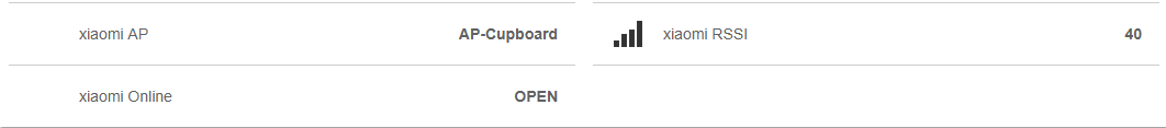

Just tried. No difference. Still reporting stuff in the binding as wored
REmoved that, no difference

No I’ve been running this config for a while…but I have switched to a docker for unifi and a docker for openhab. But I can’t see how that can change things. I think the controller is reporting it correctly as I’ve got access ot the full api, and I can see for that device it’s definitely is_wired: False
{u'latest_assoc_time': 1539892219, u'tx_bytes': 4021, u'bssid': u'xx:xx:xx:xx:xx:6b', u'ip': u'192.168.10.21', u'site_id': u'5812b812e4b02d20789c9fb7', u'oui': u'XiaomiEl', u'rx_rate': 72109, u'ap_mac': u'xx:xx:xx:xx:xx:6b', u'radio': u'ng', u'anomalies': 0, u'first_seen': 1537000371, u'usergroup_id': u'', u'qos_policy_applied': True, u'uptime': 4826, u'is_11r': False, u'user_id': u'5b9cc3b36662b806258a5b31', u'fixed_ip': u'192.168.10.21', u'hostname': u'lumi-gateway-v3_miio87296016', u'tx_bytes-r': 0, u'authorized': True, u'powersave_enabled': False, u'tx_packets': 22, u'assoc_time': 1539892219, u'channel': 11, u'radio_proto': u'ng', u'rx_packets': 573, u'noise': -106, **u'is_wired': False**, u'radio_name': u'wifi0', u'rx_bytes-r': 104, u'mac': u'xx:xx:xx:xx:xx:23', u'dhcpend_time': 2400, u'rssi': 40, u'_uptime_by_uap': 4826, u'tx_rate': 65000, u'name': u'Xiaomi-Hub', u'satisfaction': 85, u'_is_guest_by_uap': False, u'rx_bytes': 86361, u'network_id': u'5812b816e4b02d20789c9fbc', u'idletime': 1, u'signal': -56, u'ccq': 991, u'use_fixedip': True, u'_last_seen_by_uap': 1539897045, u'vlan': 0, u'essid': u'NazgulNetwork', u'tx_power': 40, u'bytes-r': 104, u'is_guest': False, u'_id': u'5b9cc3b36662b806258a5b31', u'noted': True, u'last_seen': 1539897045}
Any ideas what the code is looking for to device is wired or not? I’d assume the same field.

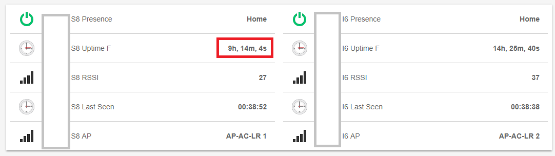

nice trick to display properly the uptime:
Unifi.rules
rule "Format S8 Uptime Display"
	Item S8_UPTM changed
	var int days = ((S8_UPTM.state as DecimalType).intValue / (86400))
	var int hours = (((S8_UPTM.state as DecimalType).intValue / 3600) - (24 * days))
	var int minutes = (((S8_UPTM.state as DecimalType).intValue / 60) - ((1440 * days) + (60 * hours)))
	var int seconds = (((S8_UPTM.state as DecimalType).intValue) - ((86400 * days) + (3600 * hours) + (60 * minutes)))
	var String result = ""
	if (days > 0) { result = result + days + "d, " }
	if (hours > 0) { result = result + hours + "h, " }
	if (minutes > 0) { result = result + minutes + "m, " }
	if (seconds > 0) { result = result + seconds + "s" }
	S8_UPTF.postUpdate(result)
then put the formatted item (S8_UPTF) on your sitemap
