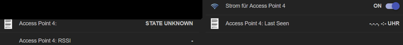

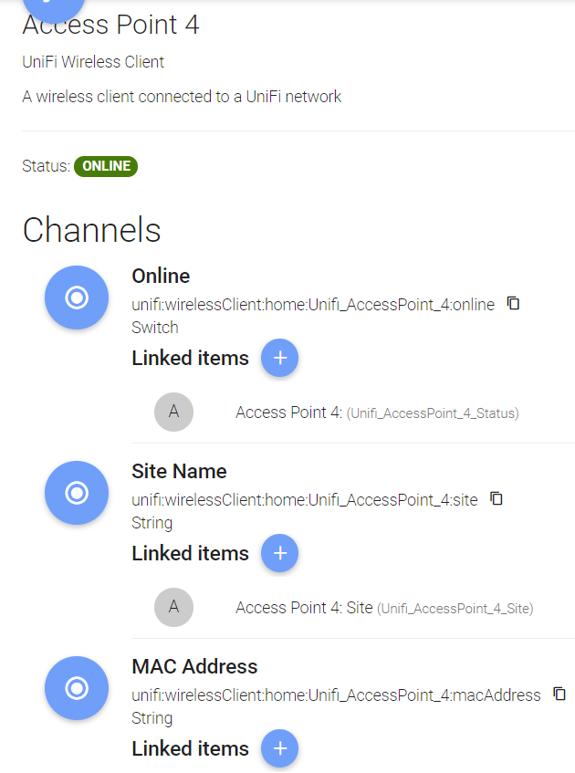

I tried 2.5 latest snapshot, in Paper UI I can see my “site” and a configured device as “online”:
But all items do not have any values.
Thanks & regards
