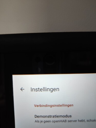

Back again. Here’s the settings menu in 2.23 (fullscreen mode). As you can see the title “Instellingen” is on top of the screen. No space above it.
Same for 3.0.0 (fullscreen mode). Now there’s also in this menu a white bar present. The word “Instelling” is already lower on the sceen.

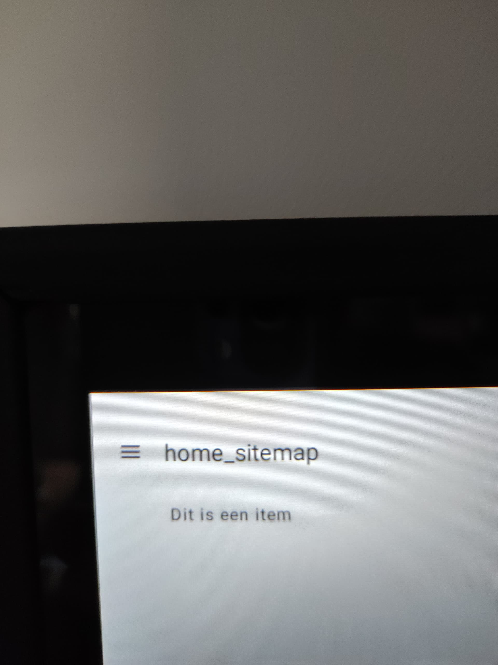

Here a sitemap with one item on 2.23
And the same sitemap on 3.0.0. Again with extra whitespace on top.

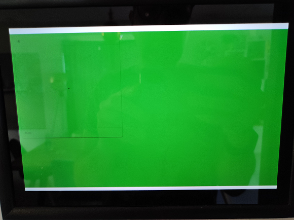

Yes, it’s also present in the main UI welcome screen. The white bar is best seen above the ‘shaded’ right edge of the menu.
But I also created a nice green screen with one label card that also reproduces the issue.
Maybe another hint. I put it on the full 1280x800. Maybe the area it scrolls now is exactly the area the white bars have ‘stolen’. Creating a new page/layout with this yaml produces it.

And last but not least, when I show this in Android studio on an emulated 1280x800 Android 10 tablet I get exact the same.
