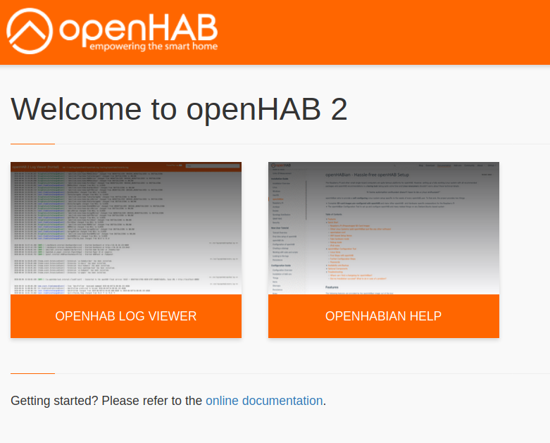

Issue of the topic: please be detailed explaining your issue
Followed the basic tutorial to install openhabian. I have a Rasberry pi 2 b V1.1
when the tutorial mentions that I could follow progress of the installation by visiting openhabiandevice but I was only able to visit it by going to the above ip addresses. It offered me to choose an UI I picked standard, as recommended. The UI then simply offeres me two options the log or the help docs.
I was expecting to see the start page as described here to be able to choose the paper UI.
Things I have tried.
I saw a warning in the log but was unable to understand it nor find reference to it being reflected like my current problem in the forum
2020-11-15 23:05:19.211 [WARN ] [raf.features.internal.osgi.Activator] - Error starting activator
java.io.IOException: Unexpected end of input at 1:1
I am able to ssh into the device and I ran the $ sudo openhabian-config and I updated the system.
I rebooted the pi.
Please post configurations (if applicable): N/A
