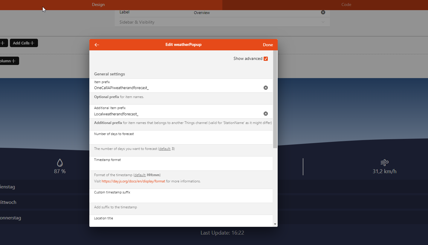

Hello again,
so i figured out. The Item Prefix has to be set in widget configuration on the page itself.
Thank you for the nice widget!!!

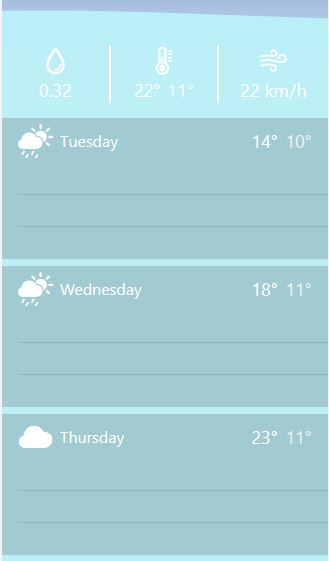

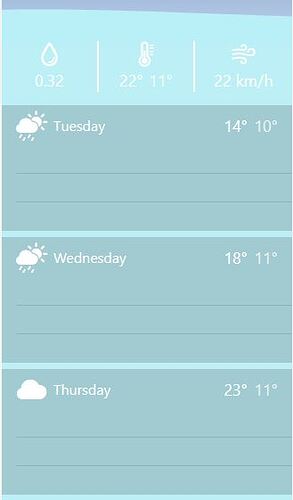

Does “Weather popup #1” widget works for anyone on OH 4.0 M3?
For me when I expand forcasted days there is no information/data (only maximum and minimum temperature)
Unfortunately i have the same problem with openHAB 4.0.1 …

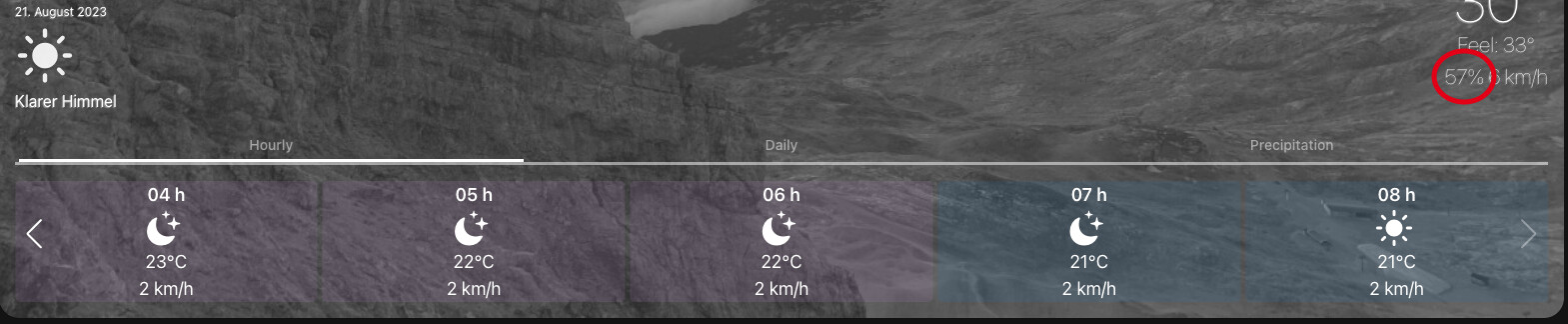

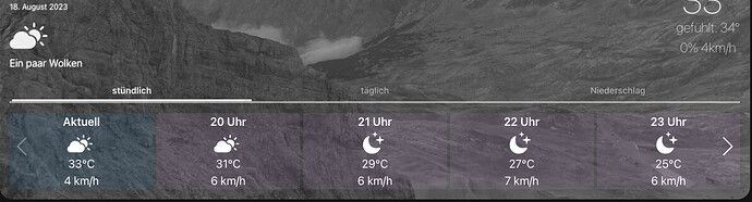

Hey guys,
@oh11: First thank you very much for the widget :blush:
Would it be possible to add a line break between temperature and wind speed in the hourly view?
What would need to be added to the code?
thanks for the compliments - but it is a community work
Attached is the requested change.

It work’s, thank you very much :blush:
The humidity was not displayed correctly.
The error is now fixed. (Line 243: I added " * 100")

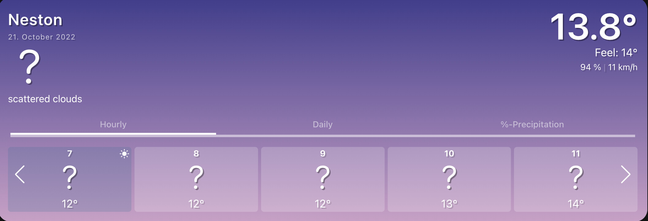

Are these widgets still working? Im getting NaN values everywhere
I just got it working again today after not using it for a while. Maybe I could help, but don’t know your starting point.

Hello, using UI and German as language the names of the items don t match to the names of the widget and it doesn t work.
ITS IMPORTANT TO GENERATE ITEMS IN ENGLISH
