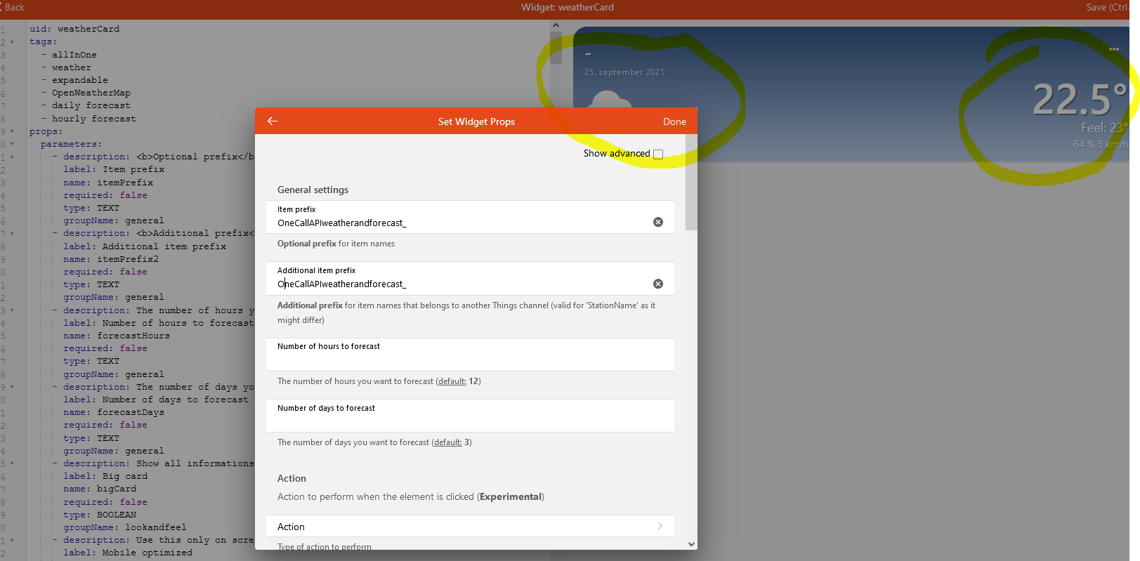

Just ran in the same problem.
This was my solution:
In the guide is written to set:
OneCallAPIweatherandforecast_
Insted, my item names were:
OneCallAPIWeatherandForecast_
(take a look at the caps).
Changing this everything went ok.
@Mordor
There is indeed a typo in it.

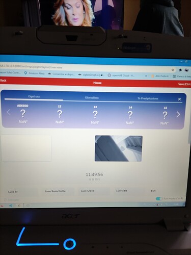

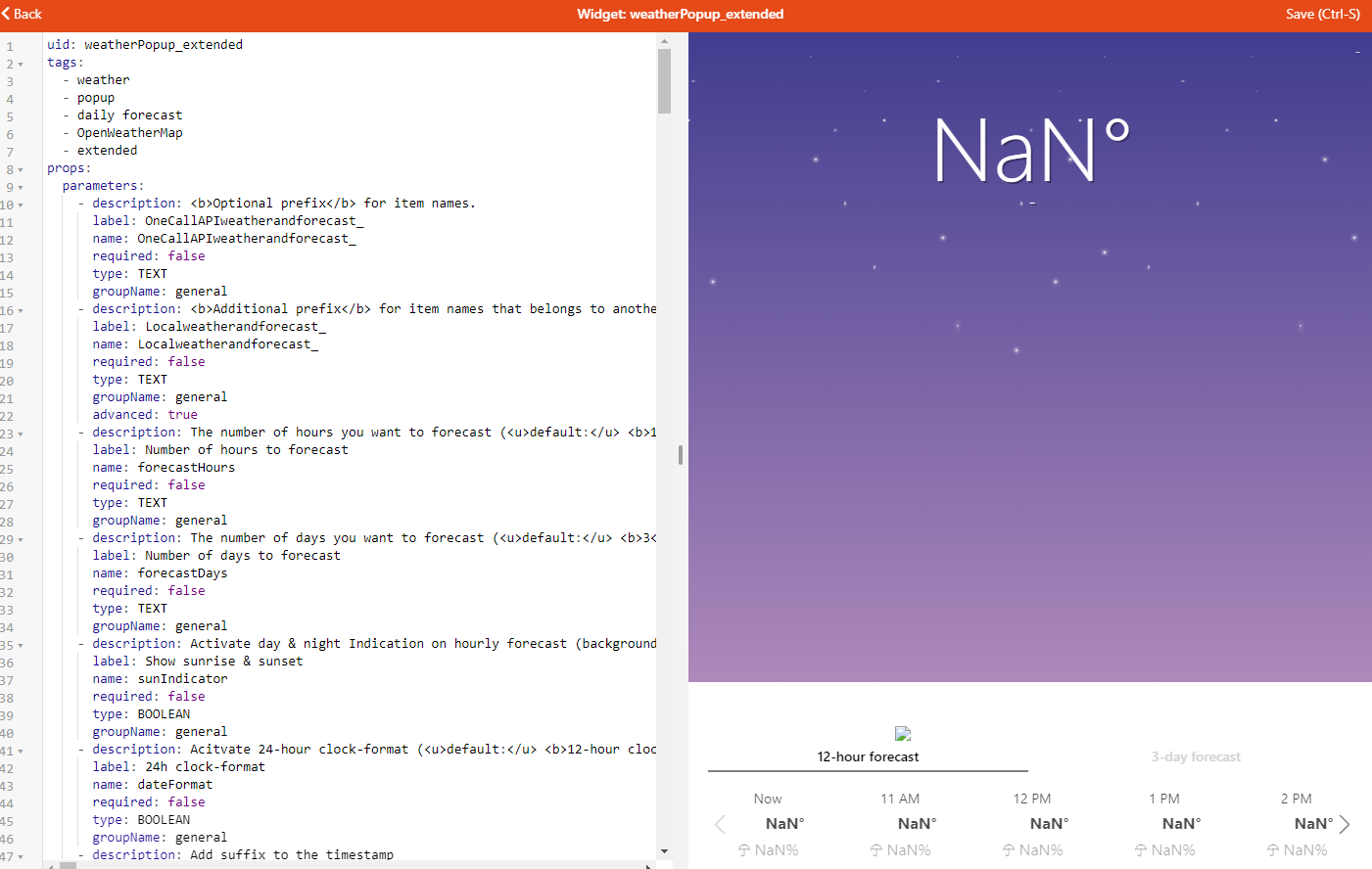

But look at the screenshot. It works with lowercase. But when i save this. and go back is empty and not working. The save function is not working.

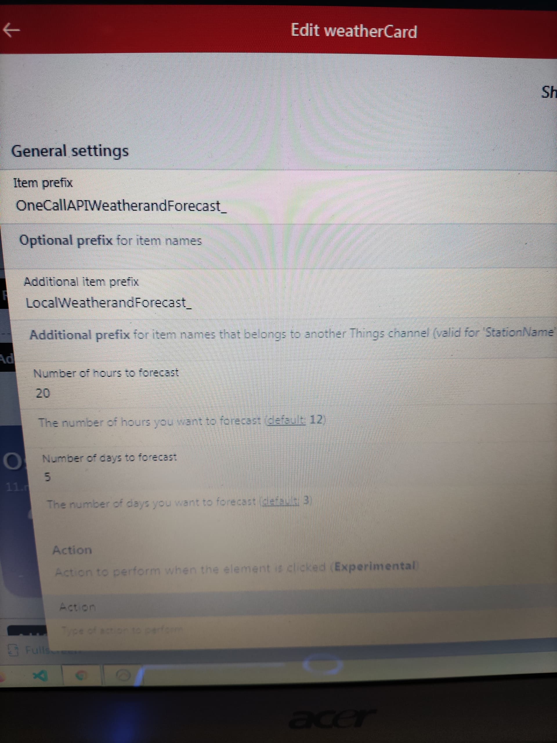

Item prefix
Additional item prefix
Localweatherandforecast_
What do I have to add before one call api and local weather , now when the items are in a different location / equipment
Thanks for the help.
hi guys, sorry I’m late but I have big personal problems …
have you solved? it doesn’t work for me with the “f” or the “F”
Yes I hade same issue as @rebzone
My items are
LocalWeatherandForecast_
I have missed uppercase
Thanks!!
i have tried with both combinations but can’t get it to work
I’m really not an expert.

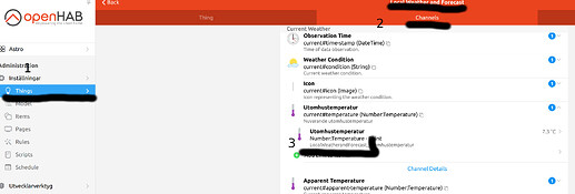

After I add all items in semantic model, (and added @RGroll code in widgets), I went back to settings/things/local weather and forecast (and one call api weather and forecast). Then looked at one item to see the prefix.
hello where can I find the weather widget you use?
Regarding to your pictures, it looks like you have “everything” / the same widget I use (if you had add all items from local weather and forecast and one call api weather and forecast from openweathermap).
I followed @RGroll first post.

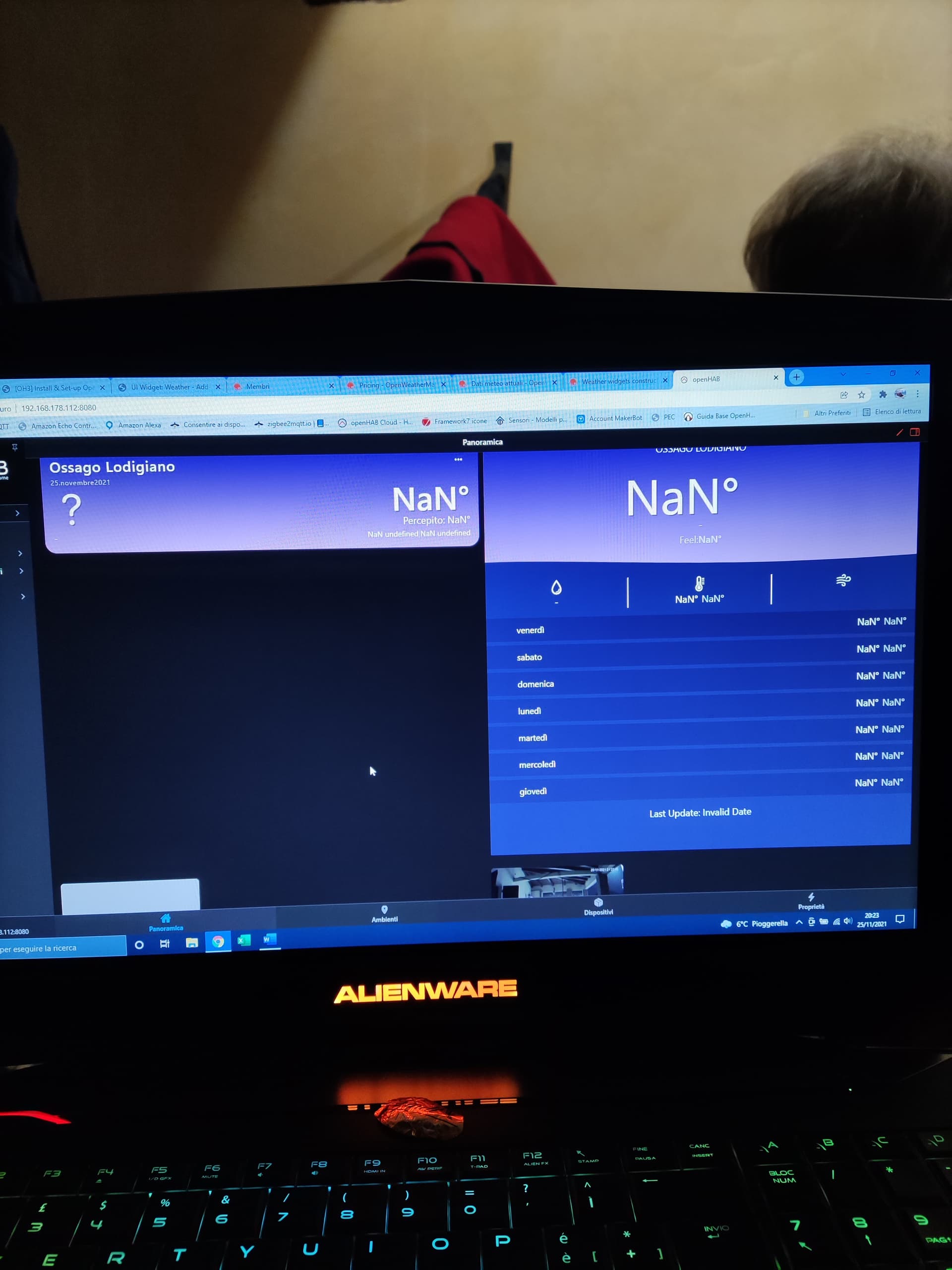

hi, i too followed @RGoll’s post but it doesn’t work, i can’t figure out where the error is
Hi everyone, I’m still here asking for your help. I redid the whole procedure but I can’t get the widget to work. i tried 2 widgets but both don’t work. advice? Thank you

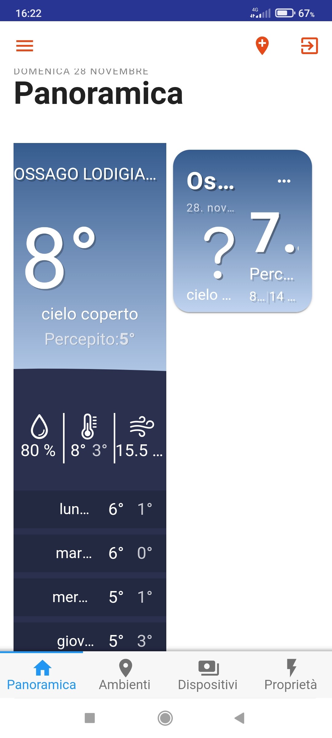

hello I don’t know how, but by tweaking a bit I managed to make it work.
however the icons of the clouds etc. do not come out. but the “?” remains, how do I solve it?
Thank you

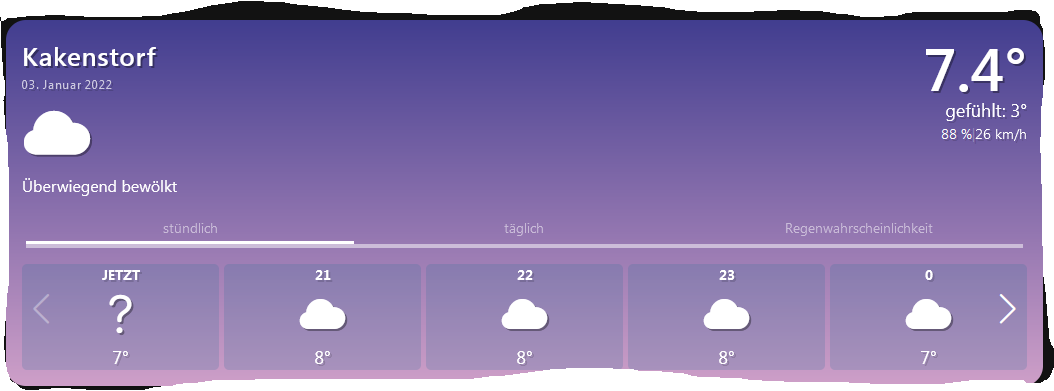

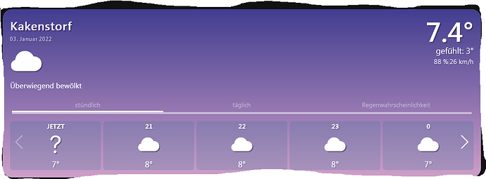

Hi @ all,
the Widget works fine, exept the actual icon of the Hourly icon.
Due to other names of my choosen items I had to change the names in the widget to get it work.
Right know I can’t find the position in the editor where this icon ? is set. May someone can tell me the line where to find?
Thanks al lot
Maik

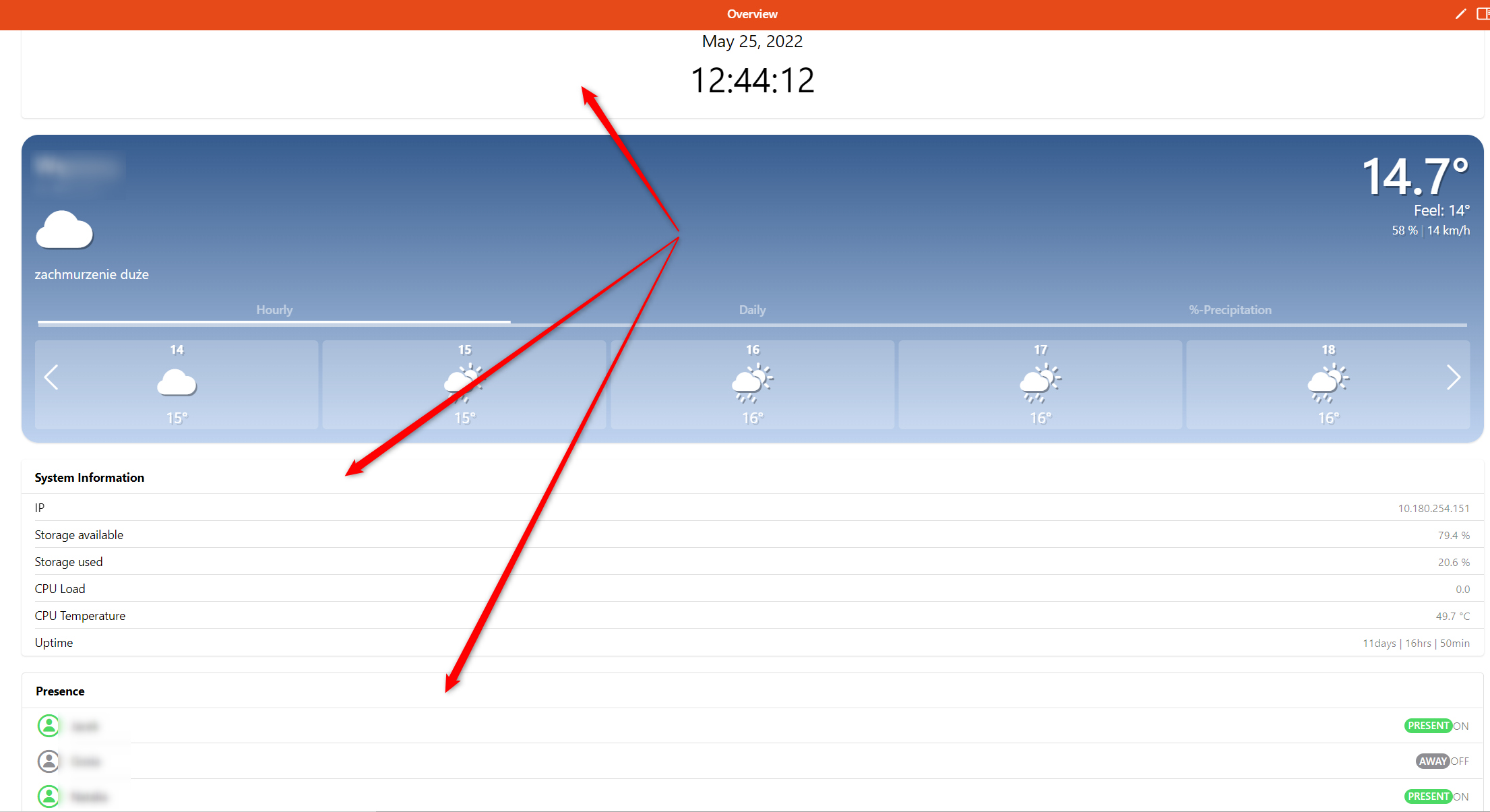

Many thanks for this widget!
I am just wondering how can I unify background colors of all my blocks (widgets) on the overview page.
Where can I find widget background color definition so i could use it in other blocks? I like this blue color and want to have the same to all
