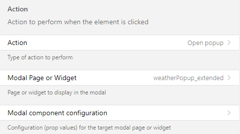

I’m not 100% sure if I understand you correct here, but I think you would like to open the weather popup widget when you click on the weather card widget?
If yes, you have to click on the Code tab while you’re editing the page and add the widget configuration parameters to the page manually (as theres a bug with the action settings for custom widgets):
                    - component: widget:weatherCard
                        itemPrefix: OneCallAPIweatherandforecast_
                        locationTitle: Some city
                        widget_action: popup
                        widget_actionModal: widget:weatherPopup
                        widget_actionModalConfig:
                          forecastHours: "12"
                          forecastDays: "3"
                          sunIndicator: true
                          locationTitle: YourCity
You could also use any of the standard elements, like a Label card…
…Select Configure Widget → Inside the seen selection you’ve to choose Open Popup as Action, the desired weather popup as Modal Page or Widget and then click on Modal component configuration to set the widgets parameter.
Hope it helps

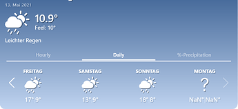

Forecast for “hours” and “Days 1,2,3” are working fine, just the last day always shows NaN / NaN.
Thing “One Call API weather and forecast” is set with 4d/13h - same is done in the weather card as well as the weather popup widget.
I added the 172(!) items several times from UI as well as via “Add Items from Textual Definition” (source) - always the same result.
What is wrong?

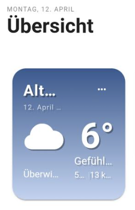

hello, I followed all the steps of the guide but the widget looks like this, why? where am I
wrong?
It looks like the items cannot be found in the item registry.
Did you create the Items from the OneCallAPIweatherand Forecast thing’s channels?
