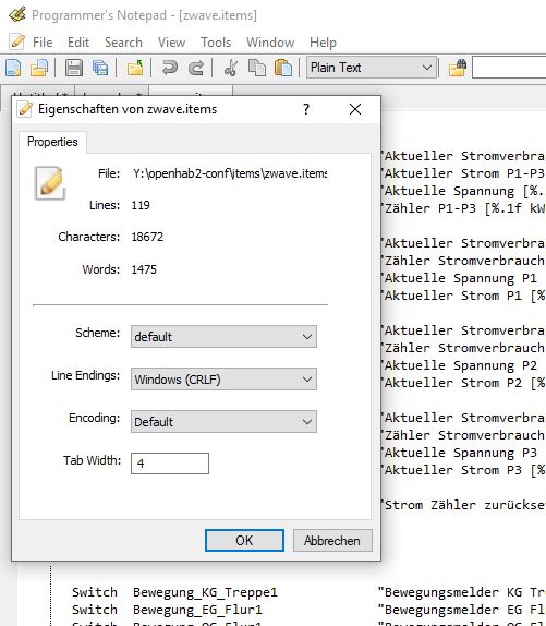

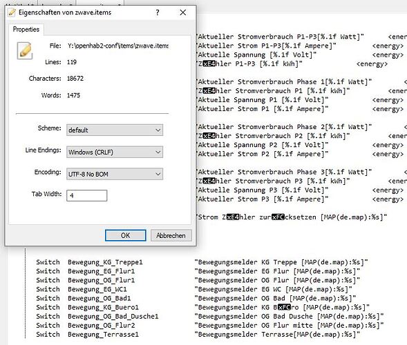

I used Programmers Notepad to fix it, see below for details
Umlaute1.jpg is the wrong formating

here my solution:
save the .things, .sitemaps, .rules and .items files with programmes notepad
encoding UTF-8 No Mark for correct display of “Umlaute”
