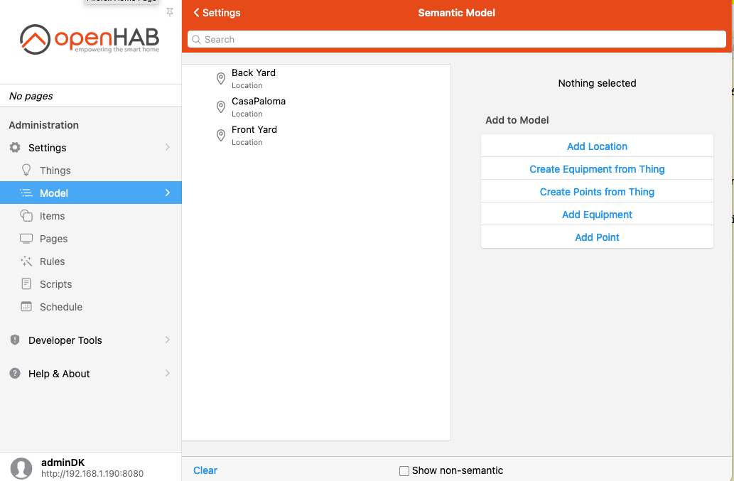

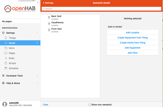

I can no longer can add nested locations when I have SELECTED a location… as there is no Add to Model table on the right side. This is with nothing SELECTED.

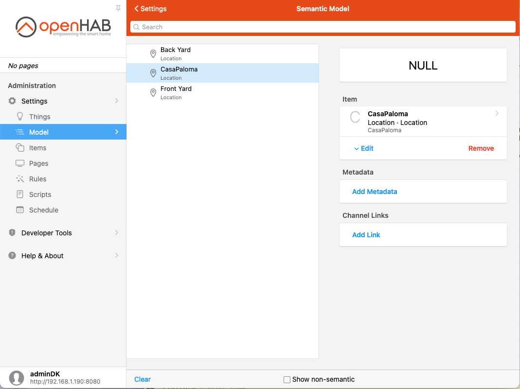

Once I SELECT my main location (CasaPaloma) expecting to add Front Yard UNDER it… the ability to Add Location under it is not there anymore (it was there in OH3.0.1 for me)
I dont know what is wrong… and unable to continue building model… any ideas?
Your Location Items are of type Location. A Location Item is an Item that holds a latitude,longitude coordinate. All Locations and Equipment Items in the model must be a Group type Item.
It is unlikely this ever worked in any version of OH 3 because only a Group can be have other Items positioned inside them in the model (or anywhere else for that matter).
