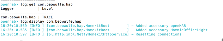

then per this page I added log:set TRACE com.beowulfe.hap
Each time I change the HomeKit config in PaperUI I do get the following [INFO] log entries but nada when trying to connect via iOS:
15:45:58.068 [INFO ] [com.beowulfe.hap.HomekitRoot ] - Added accessory openHAB
15:45:58.080 [INFO ] [com.beowulfe.hap.HomekitRoot ] - Added accessory HommieOfficeLight
15:45:58.086 [INFO ] [pl.http.impl.NettyHomekitHttpService] - Resetting connections
All this to say “hey siri please turn on the lights” and have her say "__Kerr I am not sure I understand did you say you want to fight for your right " :grinning:

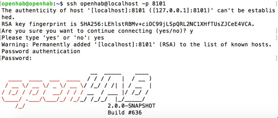

When you say
I did a “smarthome:homekit clearPairings” and a “smarthome:homekit allowUnauthenticated true” from the console
What do you mean? ssh to the server (a pi3 in my case) and run that? where do you run it?
First, ssh to your Pi with your normal user. Then run the following command. The password is habopen
ssh openhab@localhost -p 8101
after that you can type the following commands

Does anyone understand what the log below really means?

I am using OpenHABian and had problems to connect. Tried several tips, but this worked: I set the interface IP for the HomeKit service (configuration/ service/ HomeKit) and the next try I was successful.
