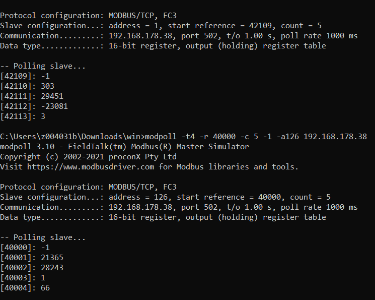

thanks for the hint, I installed mbpoll and played a little around:
First thing I updated the Sunnyboy to the newest firmware. What confuses me: In another post someone uploaded a picture showing the the Modbus ID in the SunnyExplorer → This doesn´t happen at my Sunnyboy, not even after update and restart.
Anyway, the communication seems to work, find below a screenshot of the communication:

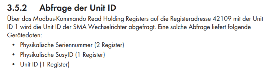

→ If 42109 & 42110 is serious number, 42111 SusyID, than 42112 should be the Unit ID, anyway the expected number (3) is stored in 42113…
Afterwards I used adress (Unit ID) 126 (3 + 123), communication worked, so I assumed I got the correct values (This is also in accordance with https://files.sma.de/downloads/MODBUS-DEN1516-V13web.pdf, where the adress is starting at 40001)
