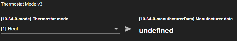

2
but looking in the Z-Wave JS UI, it just shows
In the DEBUG INFO from the UI Control Panel entry for the device there is
      "id": "10-64-0-manufacturerData",
      "nodeId": 10,
      "toUpdate": false,
      "commandClass": 64,
      "commandClassName": "Thermostat Mode",
      "endpoint": 0,
      "property": "manufacturerData",
      "propertyName": "manufacturerData",
      "type": "buffer",
      "readable": true,
      "writeable": false,
      "label": "Manufacturer data",
      "stateless": false,
      "commandClassVersion": 3,
      "list": false,
      "lastUpdate": 1758128277726
Why the Manufacturer data is under Thermostat Mode I don’t know - but it looks like that’s where the ‘type: buffer’ comes from.

Anyway it is a readable channel not writable and it does not seem to have a value or state. This is exactly why I asked for these reports. It seems useless. Maybe I should just ignore those channels.
Yes I agree it doesn’t seem useful.
Perhaps just set the Warning to Debug?
