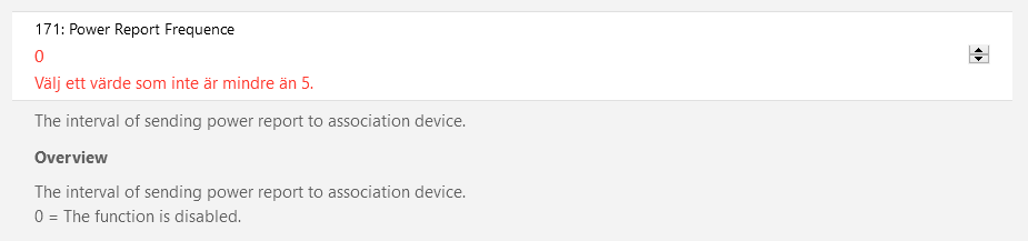

I’m not really sure if this is a binding problem or an UI problem, but I’m trying to disable periodic reporting of some values on some of my Z-Wave devices and it won’t let me.
Screenshot:
To disable the reporting I’m supposed to set this parameter to 0, but setting it to anything below 5 gives me the error (which is swedish for “Choose a value that is no less than 5”).
The device in question is a Hank HKZW-SO05.
Whoever entered that item in the database made an error. I just corrected it in the database and a snapshot binding with the new database should be available in about a week.
I suspected it was something like that. Thanks!

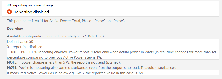

Anyway, I’ve got another case, what do you think about this one?
If I understand the instructions correctly it’s supposed to take a numerical value, but I can’t seem to change it at all. Also something wrong in the database? It’s a Qubino 3-Phase Smart Meter.
Database entry looks fine to me. What version of OH? You might need to use a snapshot version of the binding. That entry was last updated on December 27 2020. Any snapshot after December 28 should have the latest changes.
3.0 release version. But it feels unlikely that this device has been changed lately in the database, it’s not like it’s a new device. I think I edited the settings for it in 2.5 without seeing any strangeness (not 100% on that one though).

OK it was definitely changed after 3.0 was released. There is a 3.1.0-SNAPSHOT binding.
There was an issue corrected where many items were restricted to options though and that one has only 1 option.
Ah, ok! I’ll make an update then and stop whining :wink:
You will then likely need to delete & re-add the Thing to OH to get the new settings.
