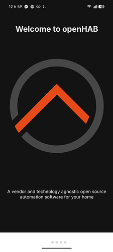

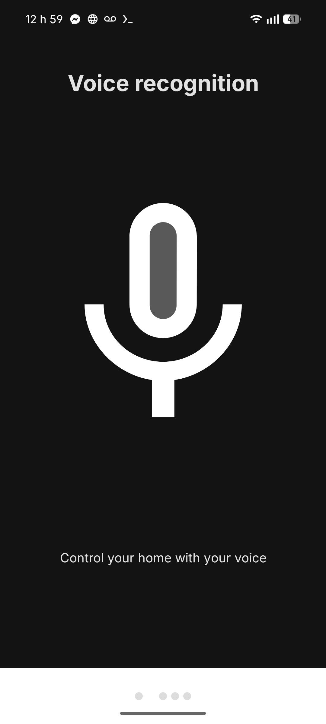

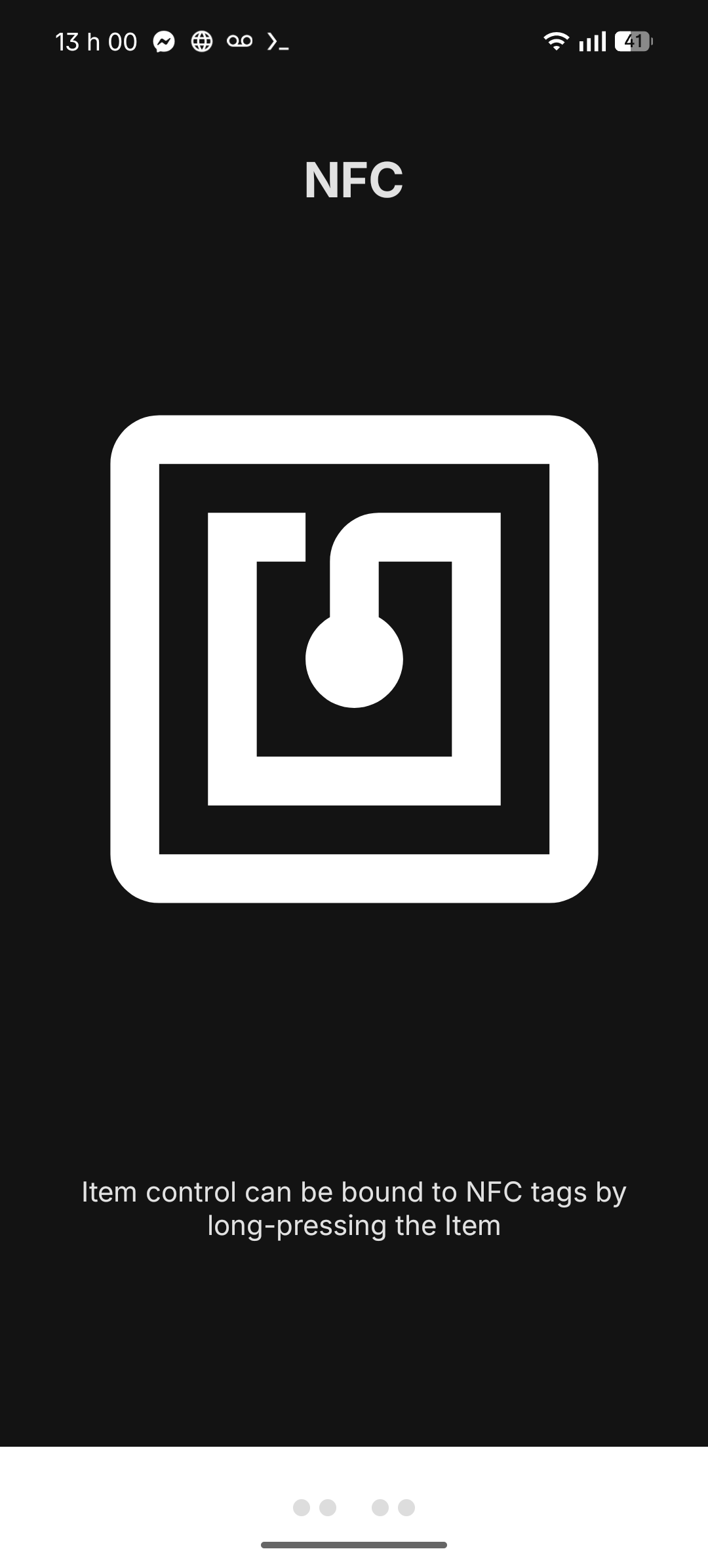

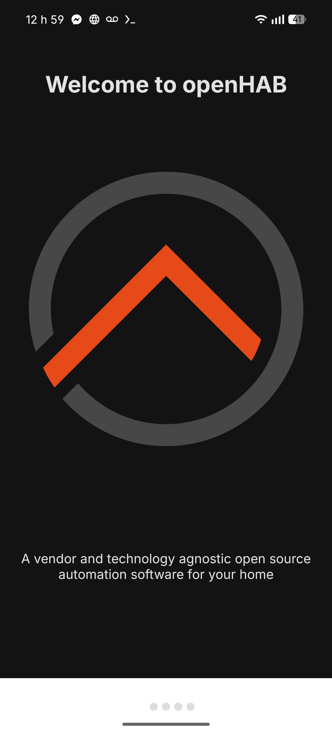

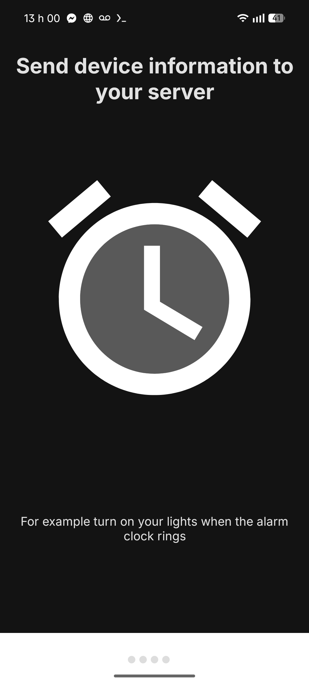

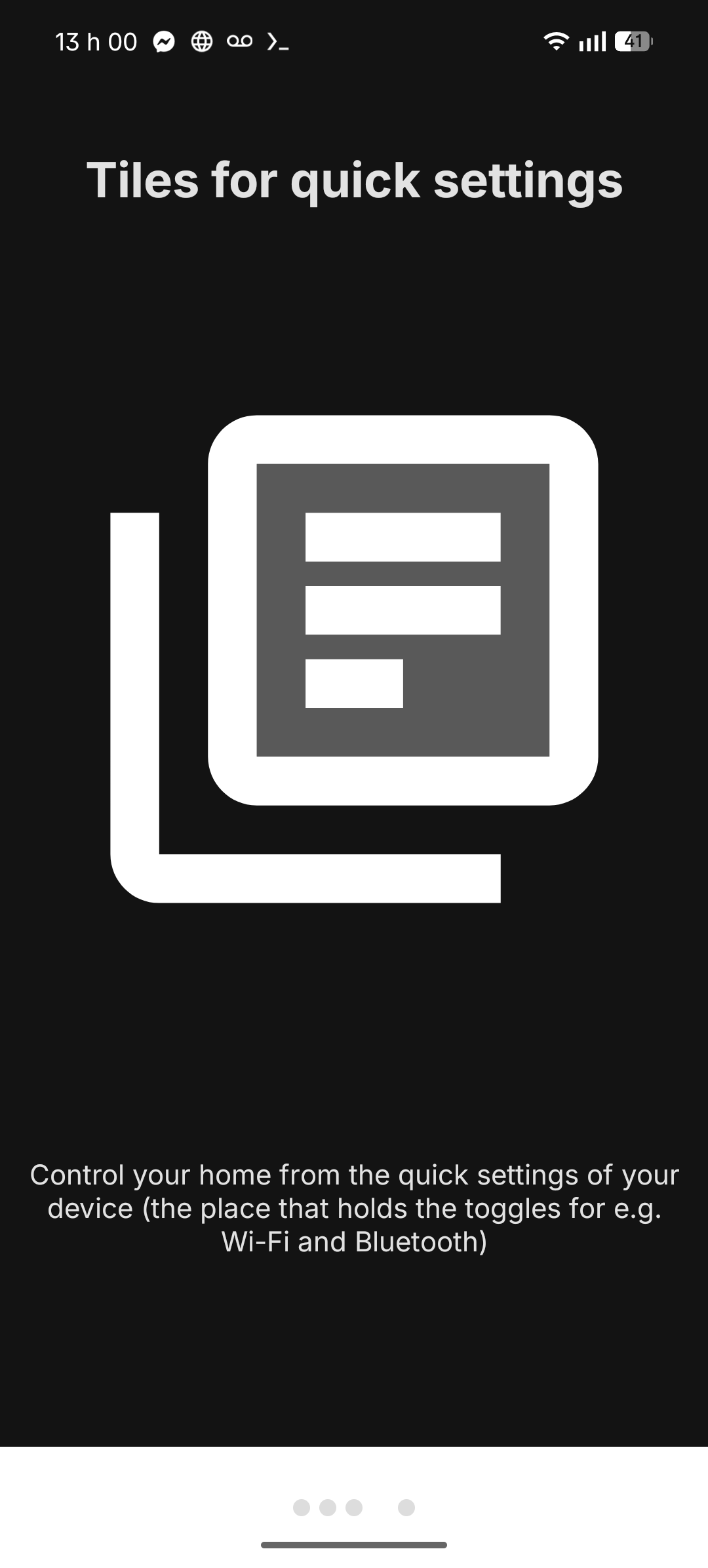

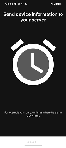

I’m experiencing an issue where I’m unable to leave what I call the “Welcome screen” on the android app. I can scroll to switch between screens that welcome me to openhab, tell me about voice recognition, NFC, Tiles for quick settings, and sending device information to the server. I can’t find a way to find a way to do anything else. I haven’t been able to find references to those pages elsewhere online, so here are some screenshots I’ve taken:

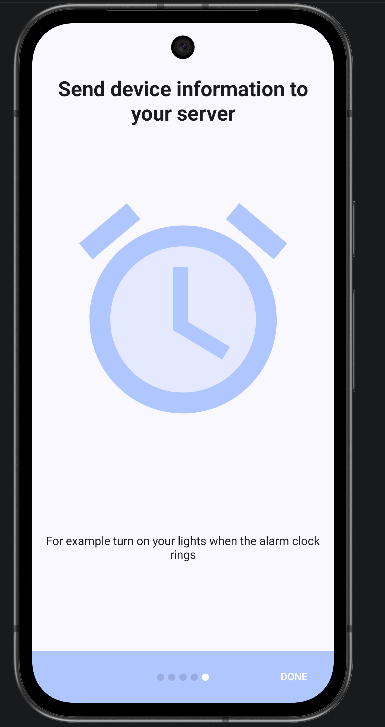

On the last page there should be a button to leave the intro in the bottom right hand corner. It could be an issue with the theme and thus white text on white background. Can you try to tap there or turn off dark mode?
Indeed, in some cases the contrast between button text and background is quite low:
Quick fix (hide intro for now): Hide intro due to low contrast by mueller-ma · Pull Request #4027 · openhab/openhab-android · GitHub
That was exactly it, thanks!
