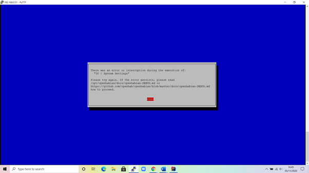

This is what happened when I tried to uninstall ZRAM
[17:41:58] openhabian@openHABianDevice:~$ sudo openhabian-config
2020-11-05_17:44:26_CET [openHABian] Checking for root privileges… OK
2020-11-05_17:44:26_CET [openHABian] Loading configuration file ‘/etc/openhabian.conf’… OK
2020-11-05_17:44:26_CET [openHABian] openHABian configuration tool version: [stable]v1.6-880(769ea17)
2020-11-05_17:44:26_CET [openHABian] Checking for changes in origin branch stable… OK
2020-11-05_17:44:39_CET [openHABian] Switching to branch stable… OK
2020-11-05_17:44:49_CET [openHABian] Updating Linux package information… OK
2020-11-05_17:44:49_CET [openHABian] Removing ZRAM service… FAILED (disable service)

This is what happened when I reinstalled from scratch on a new SD Card & edited the openhabian.conf file so clonebranch=master, debugmode=maximum, ipv6=disable and zraminstall=disable and ran /boot/first-boot.log
[19:47:05] openhabian@openHABianDevice:~$ /boot/first-boot.log

/boot/first-boot.log: line 234: +: command not found
/boot/first-boot.log: line 235: +: command not found
/boot/first-boot.log: line 236: +: command not found
/boot/first-boot.log: line 238: $‘\E[90’: command not found
/boot/first-boot.log: line 238: 01m$: command not found
/boot/first-boot.log: line 238: 49: command not found
/boot/first-boot.log: line 238: 00m: command not found
/boot/first-boot.log: line 239: +: command not found
/boot/first-boot.log: line 240: net.ipv6.conf.all.disable_ipv6: command not found
/boot/first-boot.log: line 241: net.ipv6.conf.default.disable_ipv6: command not found
/boot/first-boot.log: line 242: net.ipv6.conf.lo.disable_ipv6: command not found
/boot/first-boot.log: line 243: +: command not found
/boot/first-boot.log: line 244: +: command not found
/boot/first-boot.log: line 245: OK: command not found
/boot/first-boot.log: line 246: +: command not found
/boot/first-boot.log: line 247: +: command not found
/boot/first-boot.log: line 248: +: command not found
/boot/first-boot.log: line 249: +: command not found
/boot/first-boot.log: line 250: ++: command not found
/boot/first-boot.log: line 251: ++: command not found
/boot/first-boot.log: line 252: +: command not found
/boot/first-boot.log: line 253: 2020-11-05_17:56:48_UTC: command not found
/boot/first-boot.log: line 254: +: command not found
/boot/first-boot.log: line 255: +: command not found
/boot/first-boot.log: line 256: +: command not found
/boot/first-boot.log: line 257: +: command not found
/boot/first-boot.log: line 258: +: command not found
/boot/first-boot.log: line 259: OK: command not found
/boot/first-boot.log: line 260: +: command not found
/boot/first-boot.log: line 261: +: command not found
/boot/first-boot.log: line 262: +: command not found
/boot/first-boot.log: line 263: +: command not found
/boot/first-boot.log: line 264: ++: command not found
/boot/first-boot.log: line 265: ++: command not found
/boot/first-boot.log: line 266: +: command not found
/boot/first-boot.log: line 267: 2020-11-05_17:57:00_UTC: command not found
/boot/first-boot.log: line 268: ++: command not found
/boot/first-boot.log: line 269: ++: command not found
/boot/first-boot.log: line 270: ++: command not found
/boot/first-boot.log: line 271: ++: command not found
/boot/first-boot.log: line 272: ++: command not found
/boot/first-boot.log: line 273: ++: command not found
/boot/first-boot.log: line 274: ++: command not found
/boot/first-boot.log: line 275: ++: command not found
/boot/first-boot.log: line 276: ++: command not found
/boot/first-boot.log: line 277: ++: command not found
/boot/first-boot.log: line 278: ++: command not found
/boot/first-boot.log: line 279: ++: command not found
/boot/first-boot.log: line 280: ++: command not found
/boot/first-boot.log: line 281: ++: command not found
/boot/first-boot.log: line 282: ++: command not found
/boot/first-boot.log: line 283: +: command not found
/boot/first-boot.log: line 284: OK: command not found
/boot/first-boot.log: line 285: +: command not found
/boot/first-boot.log: line 286: +: command not found
/boot/first-boot.log: line 287: +: command not found
/boot/first-boot.log: line 288: +: command not found
/boot/first-boot.log: line 289: +: command not found
/boot/first-boot.log: line 290: +: command not found
/boot/first-boot.log: line 291: +: command not found
/boot/first-boot.log: line 292: +: command not found
/boot/first-boot.log: line 293: +: command not found
/boot/first-boot.log: line 294: +: command not found
/boot/first-boot.log: line 295: +: command not found
/boot/first-boot.log: line 296: +: command not found
/boot/first-boot.log: line 297: +: command not found
/boot/first-boot.log: line 298: +: command not found
/boot/first-boot.log: line 299: +: command not found
/boot/first-boot.log: line 300: +: command not found
/boot/first-boot.log: line 301: +: command not found
/boot/first-boot.log: line 302: +: command not found
/boot/first-boot.log: line 303: +: command not found
/boot/first-boot.log: line 304: +: command not found
/boot/first-boot.log: line 305: +: command not found
/boot/first-boot.log: line 306: +: command not found
/boot/first-boot.log: line 307: +: command not found
/boot/first-boot.log: line 308: +: command not found
/boot/first-boot.log: line 309: +: command not found
/boot/first-boot.log: line 310: +: command not found
/boot/first-boot.log: line 311: +: command not found
/boot/first-boot.log: line 312: +: command not found
/boot/first-boot.log: line 313: +: command not found
/boot/first-boot.log: line 314: +: command not found
/boot/first-boot.log: line 315: +: command not found
/boot/first-boot.log: line 316: +: command not found
/boot/first-boot.log: line 317: +: command not found
/boot/first-boot.log: line 318: +: command not found
/boot/first-boot.log: line 319: +: command not found
/boot/first-boot.log: line 320: +: command not found
/boot/first-boot.log: line 321: +: command not found
/boot/first-boot.log: line 322: +: command not found
/boot/first-boot.log: line 323: +: command not found
/boot/first-boot.log: line 324: +: command not found
/boot/first-boot.log: line 325: +: command not found
/boot/first-boot.log: line 326: +: command not found
/boot/first-boot.log: line 327: +: command not found
/boot/first-boot.log: line 328: +: command not found
/boot/first-boot.log: line 329: +: command not found
/boot/first-boot.log: line 330: +: command not found
/boot/first-boot.log: line 331: +: command not found
/boot/first-boot.log: line 332: +: command not found
/boot/first-boot.log: line 333: ++: command not found
/boot/first-boot.log: line 334: +: command not found
/boot/first-boot.log: line 335: +: command not found
/boot/first-boot.log: line 336: +: command not found
/boot/first-boot.log: line 337: +: command not found
/boot/first-boot.log: line 338: ++: command not found
/boot/first-boot.log: line 339: ++: command not found
/boot/first-boot.log: line 340: +: command not found
/boot/first-boot.log: line 341: +: command not found
/boot/first-boot.log: line 342: +: command not found
/boot/first-boot.log: line 343: +: command not found
/boot/first-boot.log: line 344: +: command not found
/boot/first-boot.log: line 345: +: command not found
/boot/first-boot.log: line 346: +: command not found
/boot/first-boot.log: line 347: ++: command not found
/boot/first-boot.log: line 348: ++: command not found
/boot/first-boot.log: line 349: +: command not found
/boot/first-boot.log: line 350: 2020-11-05_17:57:00_UTC: command not found
/boot/first-boot.log: line 351: +: command not found
/boot/first-boot.log: line 352: +: command not found
/boot/first-boot.log: line 353: +: command not found
/boot/first-boot.log: line 354: +: command not found
/boot/first-boot.log: line 355: +: command not found
/boot/first-boot.log: line 356: +: command not found
/boot/first-boot.log: line 357: +: command not found
/boot/first-boot.log: line 359: $‘\E[90’: command not found
/boot/first-boot.log: line 359: 01m$: command not found
/boot/first-boot.log: line 359: 49: command not found
/boot/first-boot.log: line 359: 00m: command not found
/boot/first-boot.log: line 360: +: command not found
/boot/first-boot.log: line 361: +: command not found
/boot/first-boot.log: line 362: ++: command not found
/boot/first-boot.log: line 363: +: command not found
/boot/first-boot.log: line 364: syntax error near unexpected token Europe/Berlin' /boot/first-boot.log: line 364: OK (Europe/Berlin)’
When I ran /usr/local/bin/FireMotD –version I got
[19:49:59] openhabian@openHABianDevice:~$ /usr/local/bin/FireMotD --version
FireMotD v12.05.191019
I ran sudo /usr/local/bin/FireMotD -S & sudo /usr/local/bin/FireMotD --theme Gray
[19:54:21] openhabian@openHABianDevice:~$ sudo /usr/local/bin/FireMotD -S
[sudo] password for openhabian:
[19:55:25] openhabian@openHABianDevice:~$ sudo /usr/local/bin/FireMotD --theme Gray
############### openHABianDevice ############################################
Ip = 192.168.0.51
Release = Raspbian GNU/Linux 10 (buster)
Kernel = Linux 5.4.51-v7l+
Platform = Raspberry Pi 4 Model B Rev 1.4
Uptime = 0 day(s). 0:2:35
CPU Usage = 0% avg over 4 cpu(s) (4 core(s) x 1 socket(s))
CPU Load = 1m: 0.73, 5m: 0.57, 15m: 0.24
Memory = Free: 7.12GB (92%), Used: 0.61GB (8%), Total: 7.73GB
Swap = Free: 0.09GB (100%), Used: 0.00GB (0%), Total: 0.09GB
Root = Free: 11.36GB (82%), Used: 2.34GB (18%), Total: 14.32GB
Updates = 16 apt updates available.
Sessions = 0 session(s)
Processes = 134 running processes of 32768 maximum processes
When I ran ip route get 8.8.8.8 | head -1 | grep -Po ‘(?<=src )(\d{1,3}.){4}’ | xargs I got this output
[19:56:22] openhabian@openHABianDevice:~$ ip route get 8.8.8.8 | head -1 | grep -Po ‘(?<=src )(\d{1,3}.){4}’ | xargs
192.168.0.51
So the IP address is now showing and I can access the online dashboard at the link http://192.168.0.51:8080/start/index but can’t be accessed at http://openhabiandevice:8080/
