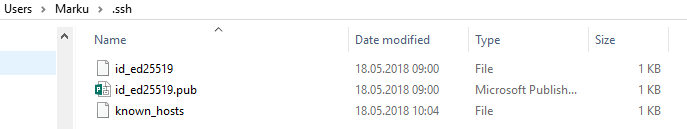

One more thing I noticed is that the Key in the .pub file and in the “known_hosts” file is NOT the same, see below screenshot from the .ssh directory on my Win 10 PC. Is that an issue ?
Is there a way to explicitly choose openssh when connecting from VSCode Powershell terminal window ?
Thanks for your help
