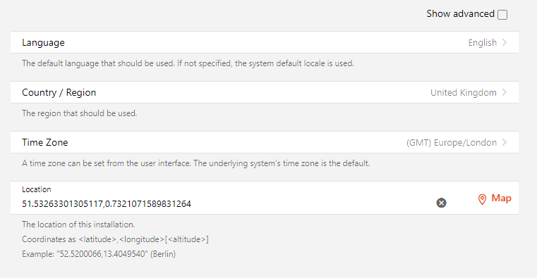

Main UI looks like this:

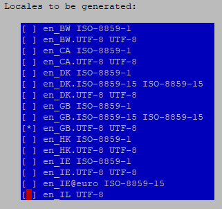

Please try to fix it manually by editing /etc/default/locale. Maybe there is a missing line for
LANGUAGE = "en_GB.UTF-8",
  LC_ALL = "en_GB.UTF-8",
LC_CTYPE = "en_GB.UTF-8",
    LANG = "en_GB.UTF-8"
also, it’s possible there is a per user directive in ~/.bashrc (search like this: cat ~/.bashrc | grep export).
the first line was commented out - is that by design?
I have made the change as described.
