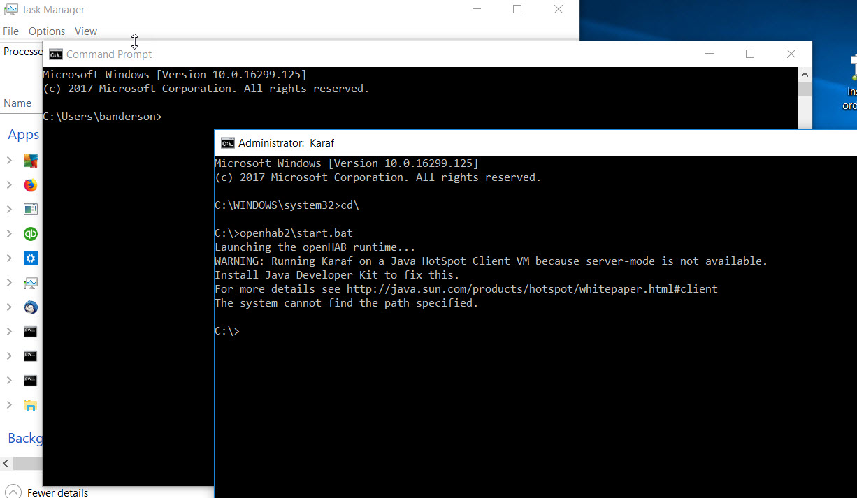

Are you running start.bat from the root or are you incorrectly running it from runtime/bin?
Thanks Rich. I did actually end up backdating to JDK 8 with no change. I not only restarted the powershell window, I restarted the machine after each change. One time I even shut down the machine, and then started back up. I’m sure it’s just something stupid, I’ll give it another shot tonight.
Hi Brian. From the root, see attached.

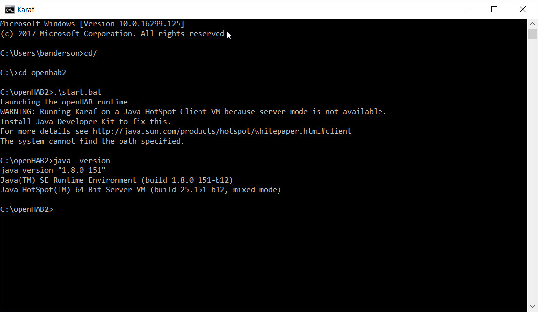

First try cd openhab2 then run .\start.bat. And if that doesn’t work, just to check: What is the output of java -version?
Hi Ben. See attached. Thanks.
FIXED
A series of java issues. 1st, I downloaded and installed JDK9.1 which is not compatible with openhab2.
I then backdated Java to JDK8.1, but absentmindedly installed the 64bit version. My system is 64 bit, and I had read that I should install 32bit Java, but glazed over at install time.
Removed all Java versions, installed JDK8.1 and now Openhab is running.
