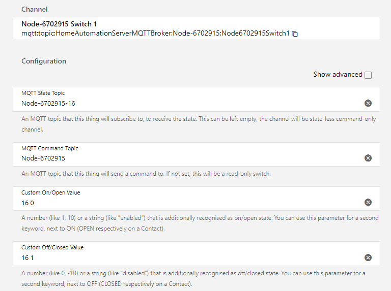

Everything is working fine except that I am not able to get the current state of the NodeMCU switches. I tried setting up the MQTT State Topic on the configuration screen but that doesn’t seems to be working.
I specified a State Topic and handled that in each of my Node MCU Client in such a way that if any message is published to that topic, the NodeMCU will publish the current state of the Pin.
However, this strategy doesn’t seems to be working.
Can someone please help me understand what wrong I am doing? Below is my Sample Configuration Screen:
Do mean something has to poll your devices, sending them some message before they respond with their own message?
openHAB does not do any active polling on MQTT, it is assumed that remote devices publish messages by themselves. It’s just not the way MQTT architecture is normally used.
stateTopic therefore just listens.
You’ll have to set up commandTopics and probably cron rules and so on if you needto create a poller mechanism.

As rossko mentioned, you can setup a cron job or similar to pull, but it does not do it automatically as most MQTT procedures actually publish from their end, that’s also easier to implement in OH then.
In general, MQTT devices publish when they have something to say i.e. a change to report. Perhaps in conjunction with a periodic summary.
OH channel stateTopic = passively subscribed to
commandTopic = actively publish to, but on demand only (by command to linked Item).
